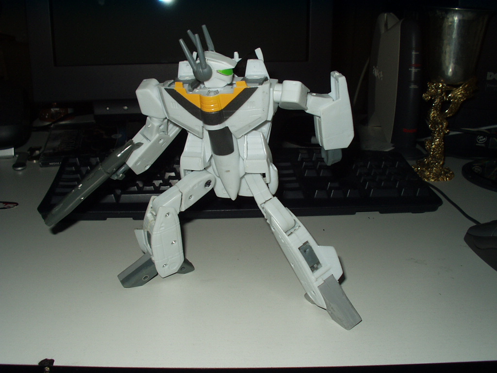

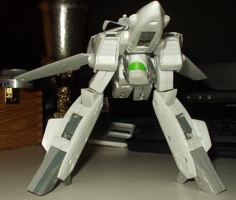

Skull-1 Posted January 15, 2006 Posted January 15, 2006 (edited) Well, I finally got around to working on the midnight blue Valkyrie from the TV series. I actually have a decent camera now so I can post a picture that shows the right color. Hope you like it so far. It has a LONG way to go but will be finished soon with some luck. Edited January 15, 2006 by Skull-1 Quote
Skull-1 Posted January 15, 2006 Author Posted January 15, 2006 (edited) Distorted color but shows the A stance pretty well. Edited January 15, 2006 by Skull-1 Quote

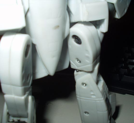

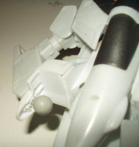

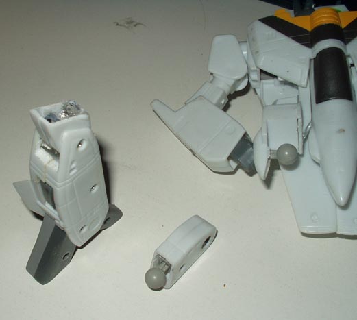

Skull-1 Posted January 15, 2006 Author Posted January 15, 2006 (edited) Here's how I did it: First of all take the elbow joint assembly from a BOOTLEG Valk... The bootleg has softer plastic and is easier to work with (and they are cheap). Then saw the thigh in half (it doesn't matter how you do it but I just did it 90 degrees from the deck). Take it all apart once you saw the thigh.... Edited January 15, 2006 by Skull-1 Quote

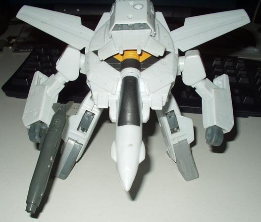

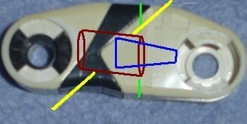

Skull-1 Posted January 15, 2006 Author Posted January 15, 2006 (edited) Cut the post out of the inside of the thigh: Then JB-WELD both halves of the top thigh segment and both halves of the lower thigh segment together. They should look like the original photo but without a screw. Take THIS part: And FILE IT DOWN to look like *THIS*: It should fit inside the LOWER section of the thigh (the part where you removed the post in the previous step). Edited January 15, 2006 by Skull-1 Quote
Skull-1 Posted January 15, 2006 Author Posted January 15, 2006 (edited) Then you file the other section of the elbow.... It should look like this. It goes in the top section of the thigh (the shorter part). When you get it all together go ahead and do a test fit, then JB-WELD (use JB-KWIK instead) the top part together with the swivel in place. When it dries glue the bottom. Sand. Install in the Valk. Edited January 15, 2006 by Skull-1 Quote

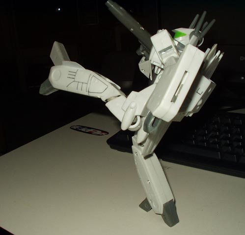

KingNor Posted January 15, 2006 Posted January 15, 2006 (edited) Hey! i did something very similar to this! only i used the ball joints from some of those lego bionicals and i put two ball joints in each leg. my system works really good in theory, but the ammount of sanding needed on the ball joint socket tended to make them extreemly weak. I'll post some pics for comparison, maybe you'll like some of my ideas. here are som poses: Edited January 15, 2006 by KingNor Quote
KingNor Posted January 15, 2006 Posted January 15, 2006 here are some pics of the joints and how i where they go, i don't have step by steps the way you do unfortunately. Quote
KingNor Posted January 15, 2006 Posted January 15, 2006 My favorite pose. i got a chunky monkey to do a standing kick pose (a dream shared, and largly un-fulfilled by most chunky monkey owners! Quote

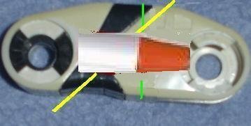

Skull-1 Posted January 21, 2006 Author Posted January 21, 2006 (edited) I've figured it out!!!!!!!!!!!!!!!!!!!!!! This is the cheapest and easiest way to modify a thigh to swivel on a 1/55 and all you need is a pair of BIC pens from WAL-MART!!!!!!!!!!!!!!!!!!!! Take the ink and pen tip out and throw them away. JB Weld them into the thigh at any angle you wish (as evidenced by the green and yellow lines). glue them perpendicular to the way you cut the thigh (I will go for the angled yellow cut next time). These pens are so tight to rotate that they will definitely hold up to the abuse and weight of a 1/55. If you still want to do it the other way you have to find some elbow joints and these are very hard to come by. Trust me I'm still trying to get some! (NOTE: THE CUT ON THE LEG HAS TO BE FROM FRONT TO REAR, BOTTOM TO TOP. THE ANGLE SHOULD BE LOWER IN FRONT THAN ON TOP. REVERSE THE YELLOW LINE AS SHOWN IN THE PICTURE BELOW. ALSO POSITION THE BIC PEN PARTS PARALLEL TO THE CUT). Edited October 30, 2008 by Skull-1 Quote

Skull-1 Posted January 21, 2006 Author Posted January 21, 2006 (edited) The pen I used is called a "BIC ROUND STICK." It's just the cheap ball point pen. The sections I am talking about are at the end of the pen you write with. You will trim the cylinder down and glue that into one section of the thigh... The other is the tapered part at the tip where the ball point goes in. They are shaped like what you see in the picture. Edited January 21, 2006 by Skull-1 Quote
Skull-1 Posted January 21, 2006 Author Posted January 21, 2006 (edited) Here you go! The white part goes into one part of the thigh the orange into the other. Plug them into each other when dry and they will swivel but still have enough friction to hold the leg solidly in place. I'd probably melt a paperclip or steel rod through each end to keep it from rotating inside the thigh (help give the JB Weld something to grip). Just run it perpindicular to the length of the pen. (NOTE: THE CUT ON THE LEG HAS TO BE FROM FRONT TO REAR, BOTTOM TO TOP. THE ANGLE SHOULD BE LOWER IN FRONT THAN ON TOP. REVERSE THE YELLOW LINE AS SHOWN IN THE PICTURE BELOW. ALSO POSITION THE BIC PEN PARTS PARALLEL THE CUT). Edited December 5, 2007 by Skull-1 Quote
KingNor Posted January 21, 2006 Posted January 21, 2006 Here you go!The white part goes into one part of the thigh the orange into the other. Plug them into each other when dry and they will swivel but still have enough friction to hold the leg solidly in place. I'd probably melt a paperclip or steel rod through each end to keep it from rotating inside the thigh (help give the JB Weld something to grip). Just run it perpindicular to the length of the pen. 362739[/snapback] this is an amazingly simple and good idea, i can't beleive i ddin't think of this. You're right about those pens, that fit should be TIGHT and will hold tons of weight i'm sure.. (well maybe not TONS) i just bid on some more boots, i'm going to try this out and then consider it for my re-ish Quote
