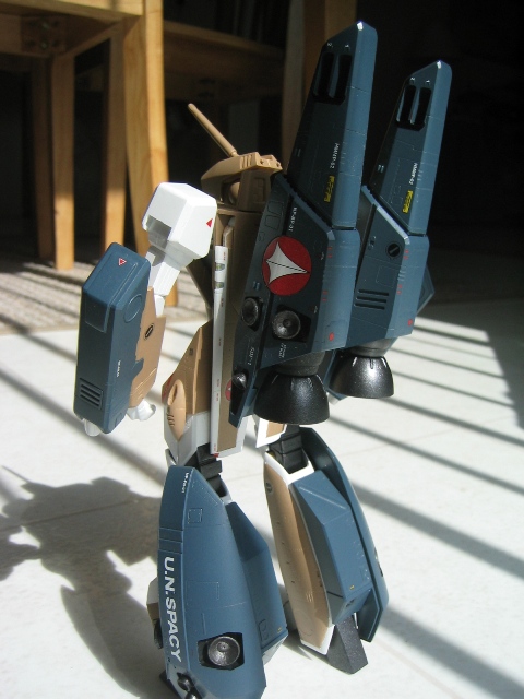

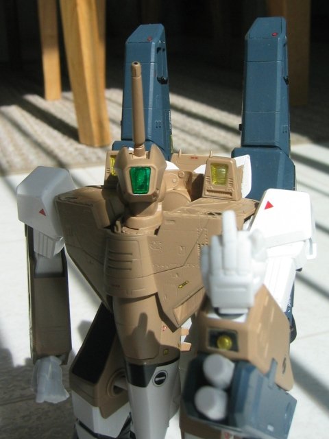

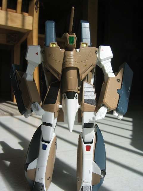

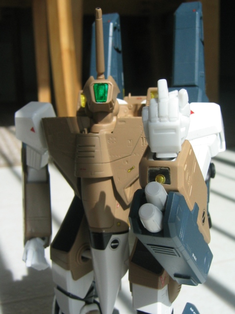

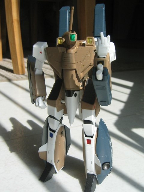

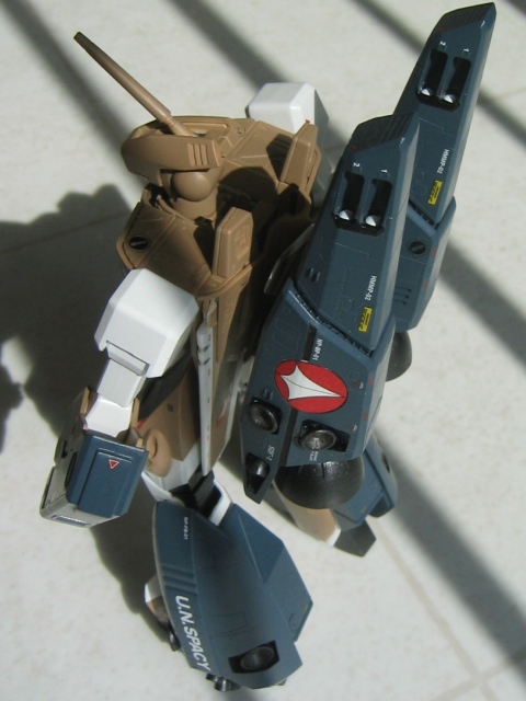

I put a heck of a lot of work into this one and it's still not done. There are a lot of little flaws that I'm not happy with but I'm proud of it just the same. This is my best work so far.
I'm scared to death of doing the panel lines because I've ruined a couple of perfectly good models doing it. I figured I'd put these pictures up before I ruin this one too.
