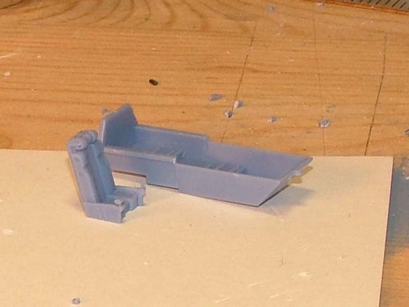

johnybgood18 Posted December 21, 2004 Author Posted December 21, 2004 The cockpit. Fairly easy assembly... It'll be ready for the paint shop soon. Quote

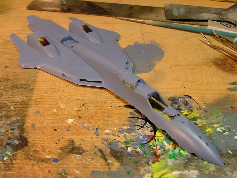

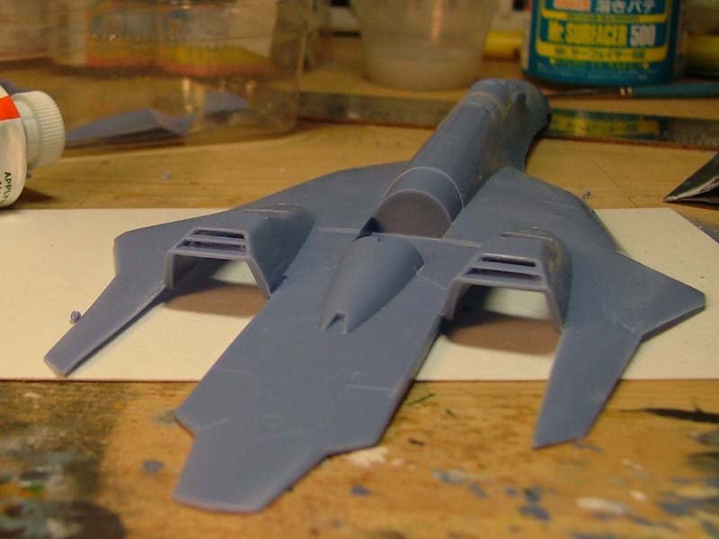

johnybgood18 Posted December 21, 2004 Author Posted December 21, 2004 (edited) The upper fuselage... Edited December 21, 2004 by johnybgood18 Quote

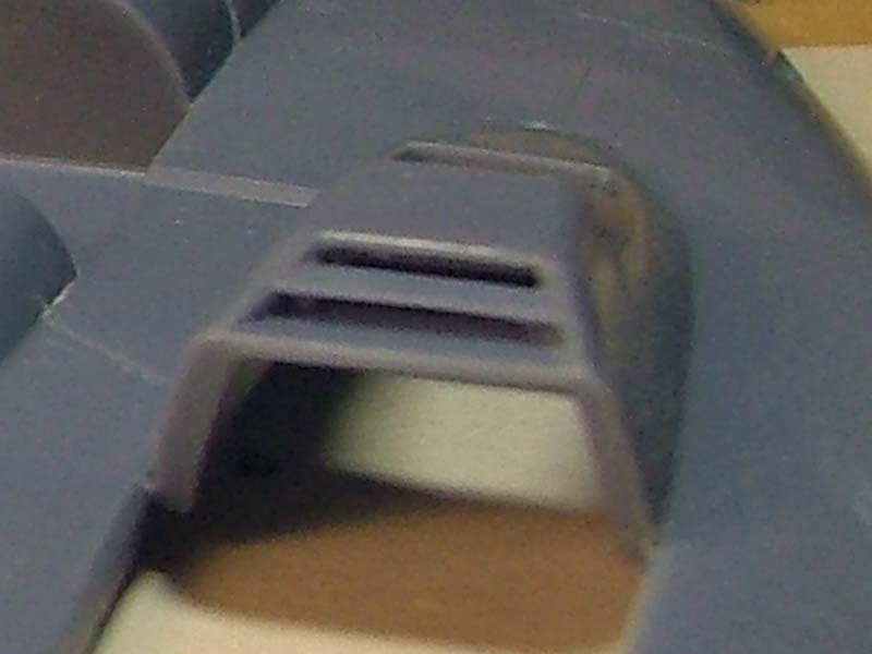

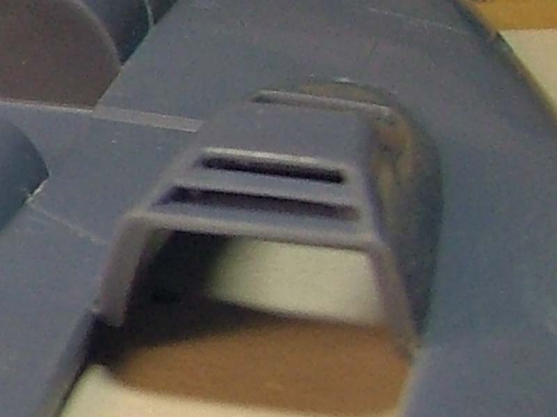

johnybgood18 Posted December 21, 2004 Author Posted December 21, 2004 And some details of the trimed vent at the back. I will do the lower ones today as I forgot to do them last night! Quote

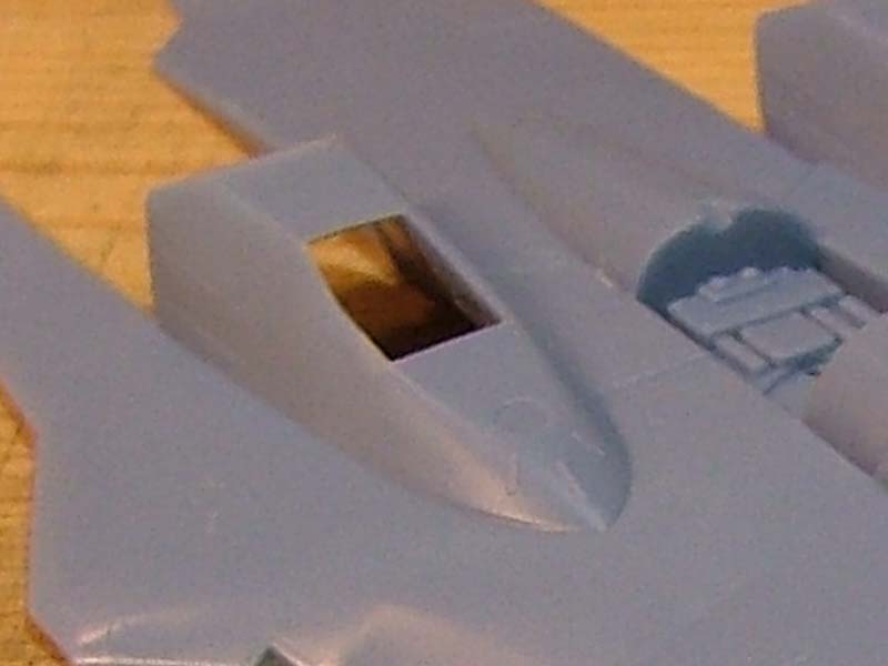

johnybgood18 Posted December 21, 2004 Author Posted December 21, 2004 The front of the upper fuselage. Quote
johnybgood18 Posted December 21, 2004 Author Posted December 21, 2004 As well as the detail of the trimmed opening. Quote

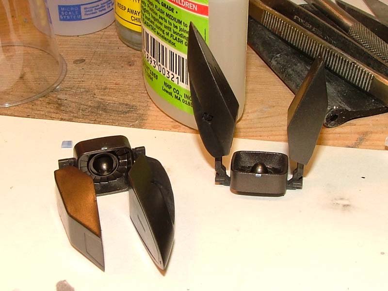

johnybgood18 Posted December 27, 2004 Author Posted December 27, 2004 (edited) Here, you have a selection of the engine exhaust/feet of the VF-19A. Edited December 27, 2004 by johnybgood18 Quote
johnybgood18 Posted December 27, 2004 Author Posted December 27, 2004 (edited) Another one... This one has the primer done. I used the ACLAD II grey primer... it turned out real bad but I decided to paint the ACLAD II gloss black anyway... after all, it's the first time I'm using this stuff, so why not experiment? Well... it turned out really ugly and I had to sand everything down. I then resprayed the whole exhausts and engine nacelles Tamiya flat black. The result was a much more smooth finish. I then applied the ACLAD II gloss black. I used the engine exhaust color for the burnt finish and used steel for the rest. The finish is not perfect but it's the best I can do for now... maybe for another project my skill will be better... who knows! Edited December 27, 2004 by johnybgood18 Quote

johnybgood18 Posted December 27, 2004 Author Posted December 27, 2004 Her, you have the painted engine exhaust. You can't really see the difference in the finish here... and in real life too! :-/ I'll have to experiment some more... maybe redo the base coat for the other color... but that is for another model! I would like to thank MW Cheng for all the nice tricks I learned here! You created another monster... shame on you! ;-) Quote
johnybgood18 Posted December 27, 2004 Author Posted December 27, 2004 The completed egine exhaust, ready to be inserted in the nacelles. There are 2 little spot I didn't bother to touch up because once they are inside the nacelles, you can't see them... good enough for me! And besides... I'm the only one to know that, right? ;-) Quote

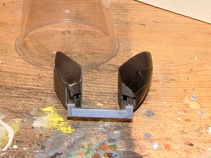

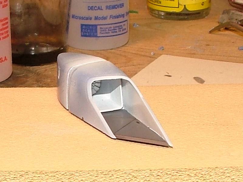

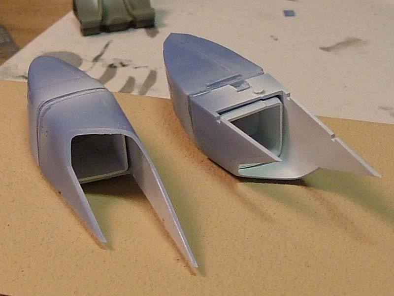

johnybgood18 Posted December 27, 2004 Author Posted December 27, 2004 On to the engine nacelles... The front one after painting... Quote
johnybgood18 Posted December 27, 2004 Author Posted December 27, 2004 and after assembly! I cut the little assembly tab on the top front part so I could paint them separately. I think it's better this way as you can get the paint everywhere and not miss a single spot. Quote

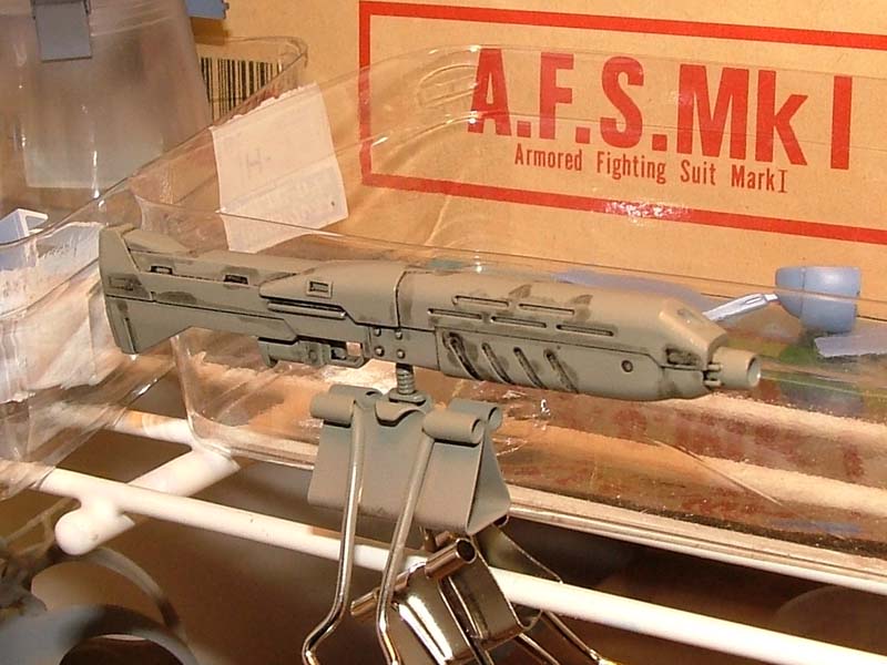

johnybgood18 Posted December 27, 2004 Author Posted December 27, 2004 Ok, how about a pic of the gun with the wash on it? The wash is artist oil paint that comes in tube diluted with odorless thinner found in an artist supply store. Quote

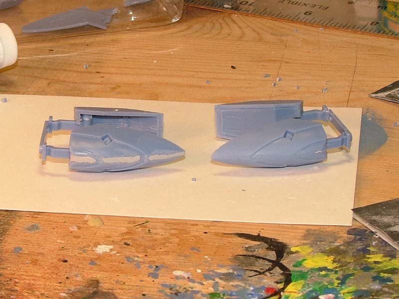

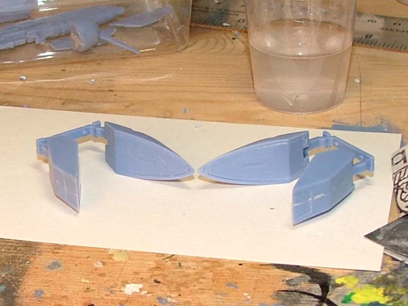

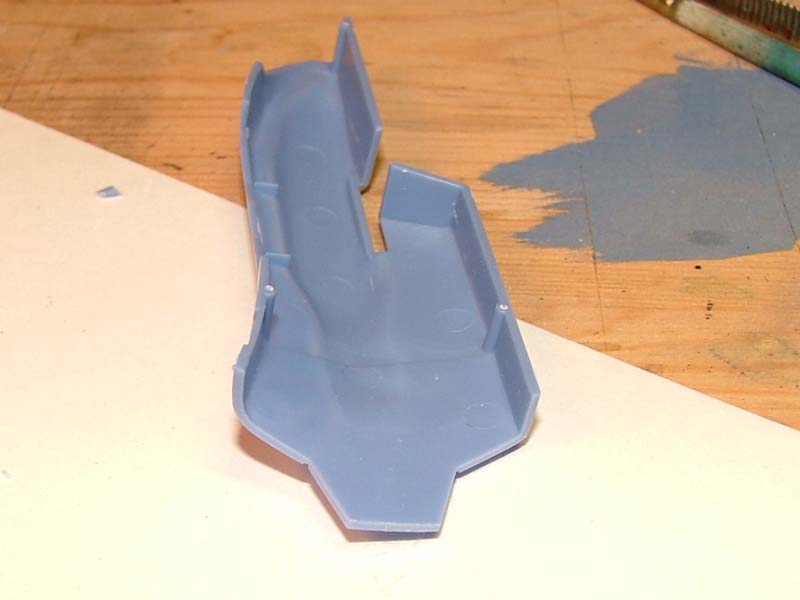

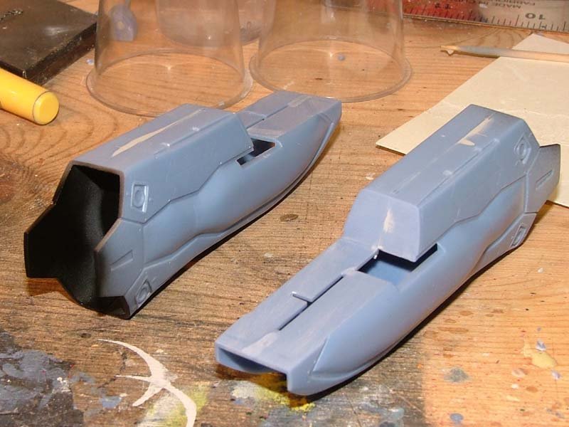

johnybgood18 Posted December 27, 2004 Author Posted December 27, 2004 Ok, back of the engine nacelles... On this one, the interior of the nacelle on both sides were full of ejector pin marks. I had to sand these down. They were very light so it was quite easy. The heavier ones received a bit of Mr. Surfacer 500. Quote
johnybgood18 Posted December 27, 2004 Author Posted December 27, 2004 And here are the assembled, sanded but not rescribed, nacelles. Quote

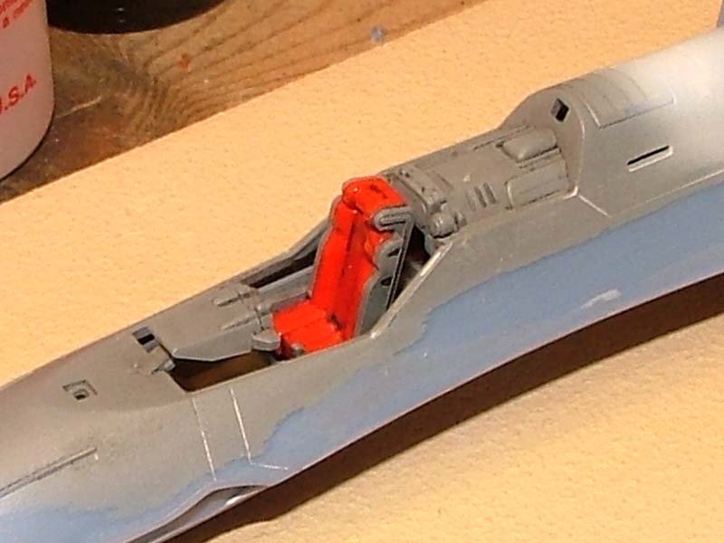

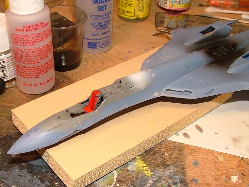

johnybgood18 Posted December 29, 2004 Author Posted December 29, 2004 Ok... back for more! Here is the fuselage with the cockpit, before masking it for painting. Quote
johnybgood18 Posted December 29, 2004 Author Posted December 29, 2004 (edited) A close-up of the cockpit. Edited December 29, 2004 by johnybgood18 Quote

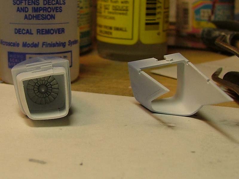

johnybgood18 Posted December 29, 2004 Author Posted December 29, 2004 One of the front engine nacelle after assembly and the interior painted. Quote

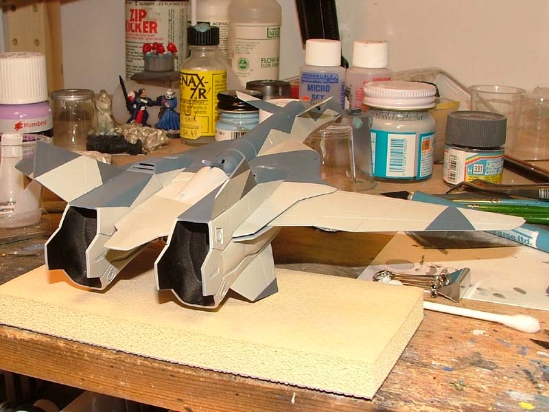

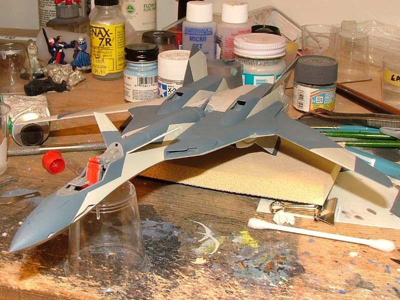

johnybgood18 Posted December 29, 2004 Author Posted December 29, 2004 The VF-19A after the first coat of the camo has been applied. There is a few of the under different angles. This idea of camo came out from a website. This site is from a guy who has his own brand of paint. He has a lot of different camo. It is a variation of the Ferris scheme. Other than that, I have no idea from or what it is exactly. I just thought it was cool! I tried to stick as close as possible to the FS number of the real thing. I just couldn't find a real match for the dark gray so I had to improvise. The guy does sell it but my problem is time. I'm moving in about 2 weeks and I really want to finish this kit before I move, I couldn't afford to wait for weeks for this paint since it's coming from Europe! So here goes... any comments are most welcome! Next step is the clear coat... and I'll try "Future" this time. Quote
johnybgood18 Posted December 29, 2004 Author Posted December 29, 2004 As you can see, some touch ups are needed. I'm just waiting for the paint to really cure before touching it again. Quote
