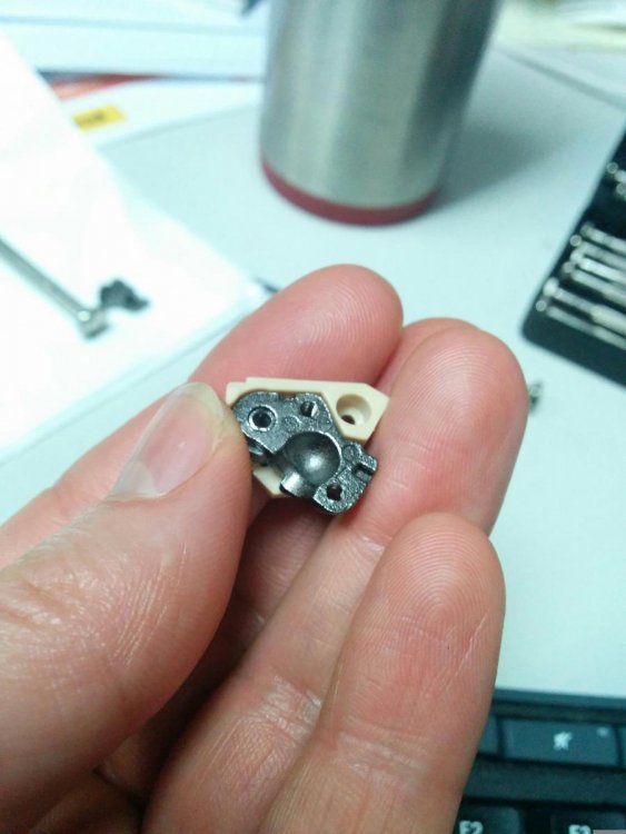

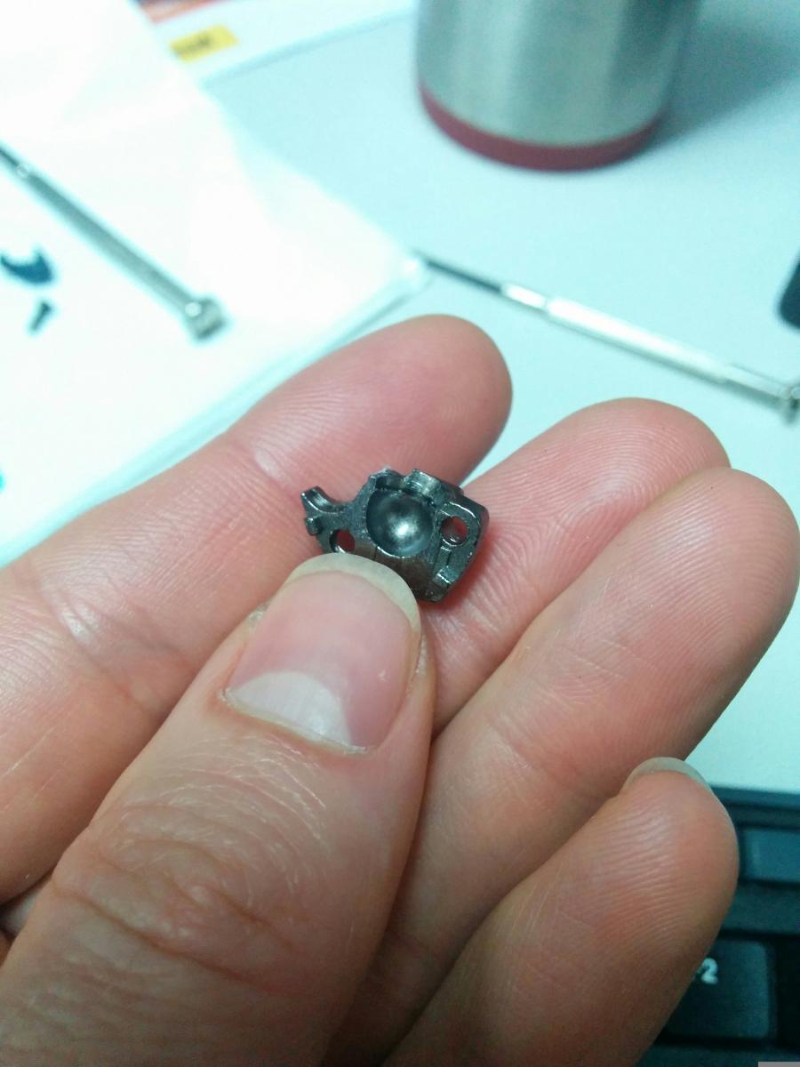

seti88 Posted September 11, 2015 Posted September 11, 2015 *gently turn the thigh halves...* been stuck on it for half an hour.....time to rest.... Quote
seti88 Posted September 11, 2015 Posted September 11, 2015 after few more tries... never tot i would go this far, at least to dissamble a valk. A new experience for me..and..upon examination of the metal socket, the plastic bit is absolutely bonded into the socket wall. No leeway to move at all..I tried giving it a few knocks but it doesnt seem to budge. Will have a look at it later again..... Quote
ChaoticYeti Posted September 11, 2015 Posted September 11, 2015 Glad you finally got it apart. Glue in the socket is what caused my issues as well. Quote
no3Ljm Posted September 11, 2015 Posted September 11, 2015 after few more tries... DSC_18071.jpg giphy.gif never tot i would go this far, at least to dissamble a valk. A new experience for me..and..upon examination of the metal socket, the plastic bit is absolutely bonded into the socket wall. No leeway to move at all..I tried giving it a few knocks but it doesnt seem to budge. Will have a look at it later again..... Looks like you have a broken peg from one of the thigh halves. That happened to me too on my VF-0D. By the way, while you're at it, tighten also the knee swivel joint since the thigh halves are already open just in case for the future. To prevent the VF-0 doing uncontrollable splits. Quote
seti88 Posted September 12, 2015 Posted September 12, 2015 Looks like you have a broken peg from one of the thigh halves. That happened to me too on my VF-0D. By the way, while you're at it, tighten also the knee swivel joint since the thigh halves are already open just in case for the future. To prevent the VF-0 doing uncontrollable splits. I guess i dont have surgeon hands or the patience and i went rambo on it. i couldnt quite tell where some of the pins where especially for the front of the thigh. Perhaps as further info, will mark it out once i got everything sorted out. now i got it revealed i can do the maintenance stuff like you said... Quote
seti88 Posted September 12, 2015 Posted September 12, 2015 Glad you finally got it apart. Glue in the socket is what caused my issues as well. mind boggling...then i realised they may have assembled the hip to the metal rod by dabbing a bit of bonding agent and pressing the 'completed closed leg' to the metal rod.... i dont thk this problem would happen if they bonded the plastic piece first to the rod (let it cure) and then closed up the leg. I couldnt see it as part of their process explanation, but quite literally thats one of the way to get overspill of bonding agent into the socket area... just like squishing a sandwhich together ur bound to get juice running out... Quote
mickyg Posted September 12, 2015 Posted September 12, 2015 (edited) I don't understand why it's needed at all. The plastic cap needs no bonding agent to the metal part in any way; the socket should hold the entire assembly together just fine. Boggles my mind. Although, judging by the pic chaotic yeti posted before, maybe it's that way due to the plastic part being slightly bigger than a hemisphere? But again, why do it that way? Edited September 12, 2015 by mickyg Quote

seti88 Posted September 12, 2015 Posted September 12, 2015 I don't understand why it's needed at all. The plastic cap needs no bonding agent to the metal part in any way; the socket should hold the entire assembly together just fine. Boggles my mind. Although, judging by the pic chaotic yeti posted before, maybe it's that way due to the plastic part being slightly bigger than a hemisphere? But again, why do it that way? I thk the adhesive was meant to avoid the ball rattling in the metal socket or provide some form of pressure against the half metal ball. i have updated findings in the maintenance thread, http://www.macrossworld.com/mwf/index.php?showtopic=41401&page=2#entry1221873 as not everyone may be interested to read it here. The plastic ball certainly looks like ill fitting, it looks bigger than the metal half ball and i also had problems getting it to sit flush against the metal half ball. Quote

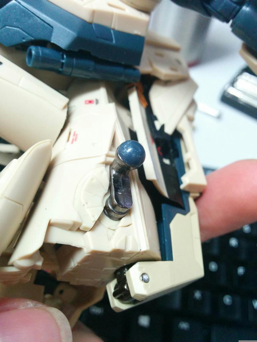

Garfinkel Posted September 12, 2015 Posted September 12, 2015 Just picked up my 0A from the post office and its a beauty. However There is a mysterious rattle in the right leg when you tilt it. Sounds like a loose piece of plastic. Everything in the leg seems to function though. My hips are fine, but the right ankle has zero tilt to it. It appears that the joint has been glued in the same way as people are finding with their hips. I can't decide what to do about it. Contact HLJ and see what they offer or, try some invasive surgery. Quote
Ignacio Ocamica Posted September 12, 2015 Posted September 12, 2015 The ankles are extremely tight you should be able to move them. Quote

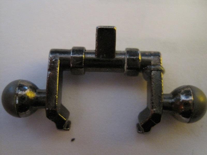

ChaoticYeti Posted September 12, 2015 Posted September 12, 2015 On the topic of expensive toys and the ball joints they utilise, let me show everyone the ball joints on the recent Bandai VF-19Advance toy: IMG_20150825_1509361.jpg And both halves of the socket: IMG_20150825_1509251.jpg IMG_20150825_1509091.jpg Look at where the screw holes are. With that assembly the socket can apply pressure to the ball. One of the downfalls of the arcadia setup is that there is only one screw and it can not apply enough pressure on the ball. Thanks for the pics! Quote
