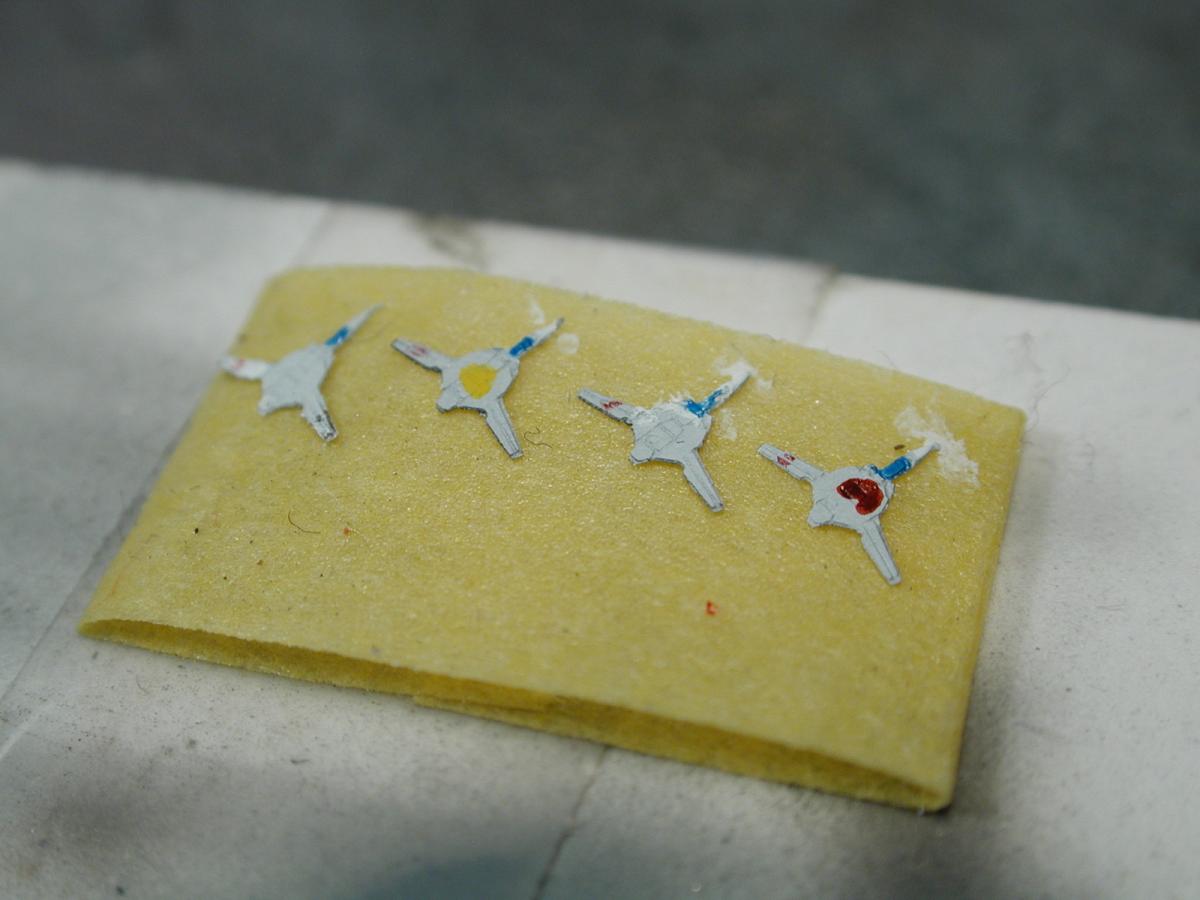

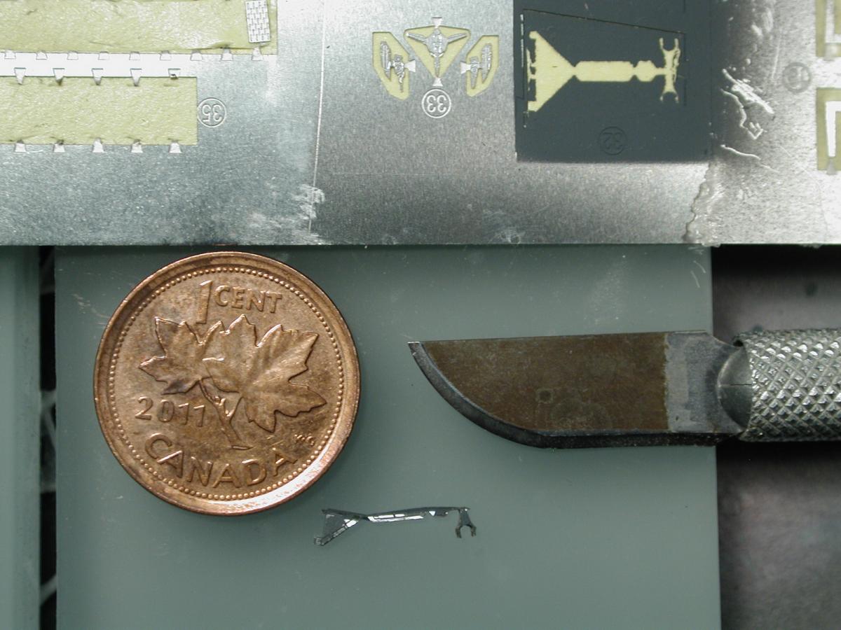

I've gotta thank Manji from these forums here once again. He provided me his un-used photo-etched extras from his Yamato kit - and actually gave me the boost I needed to start this project. Thanks so much, I really owe you one!

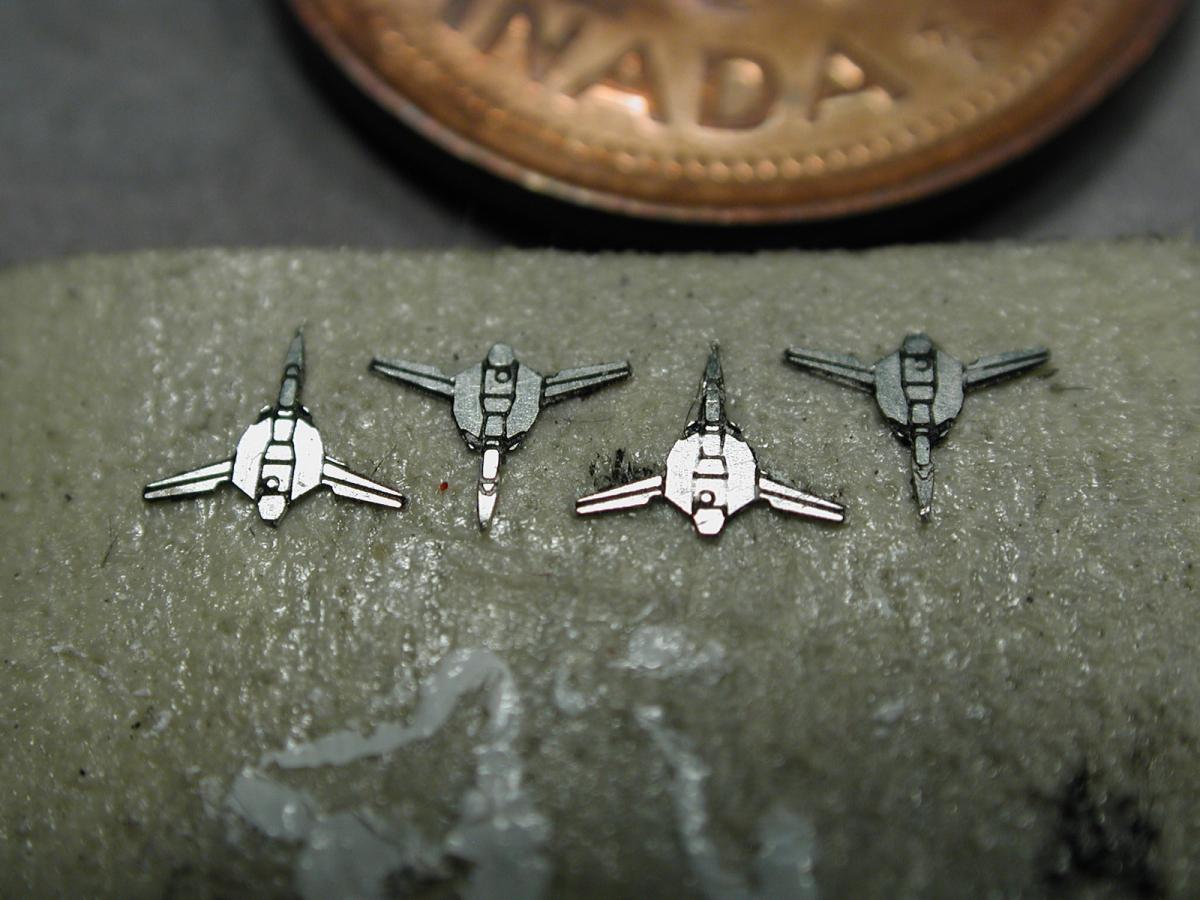

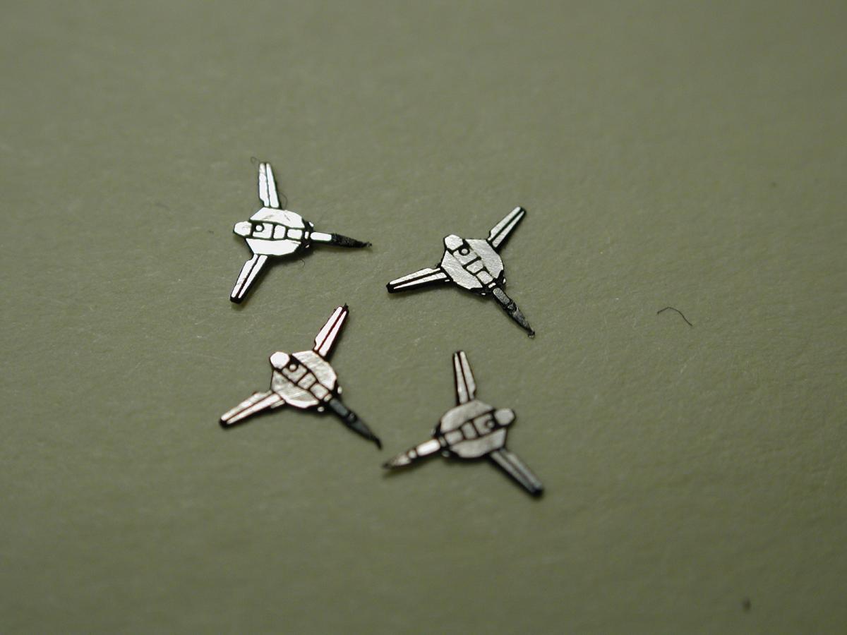

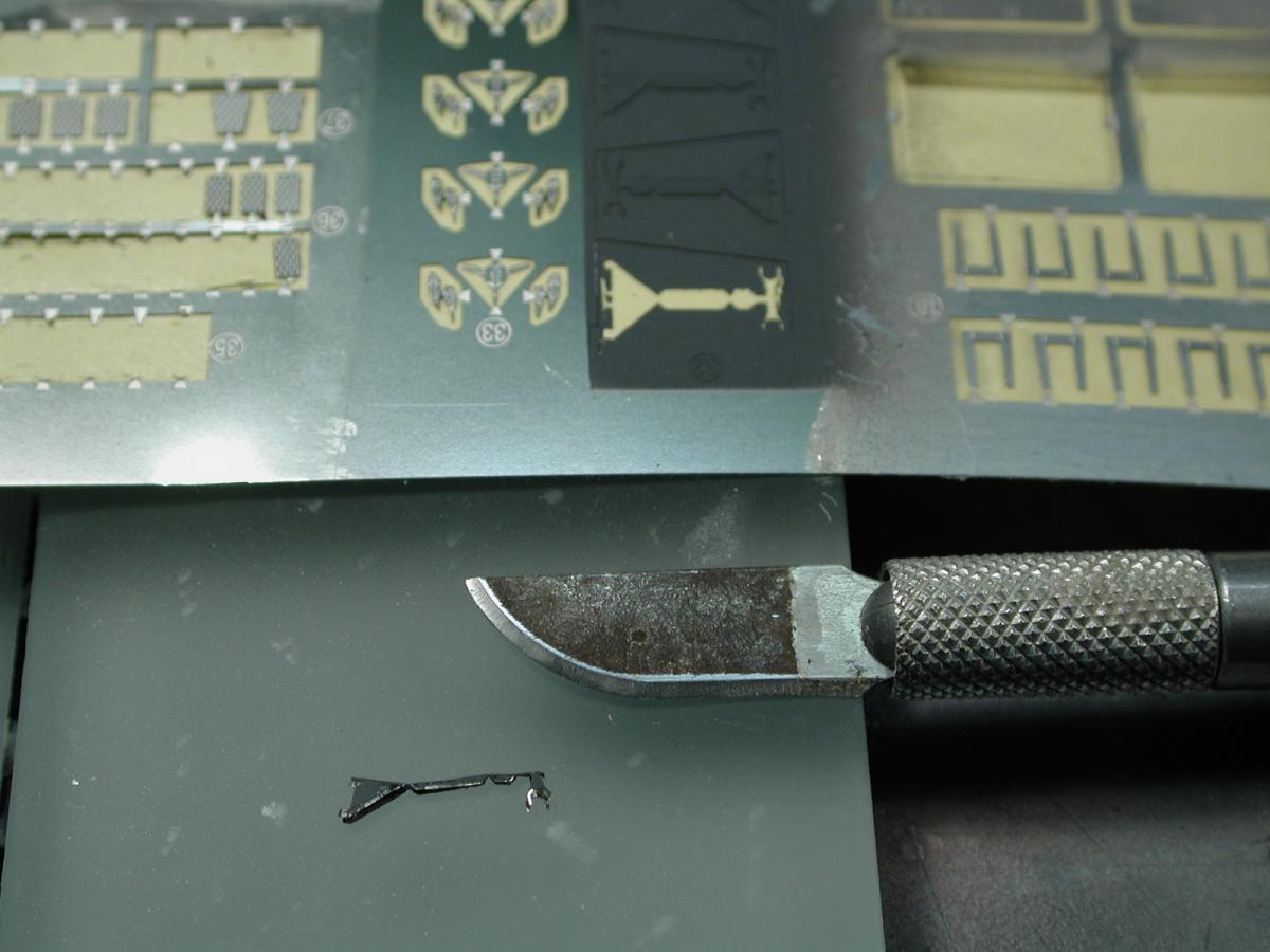

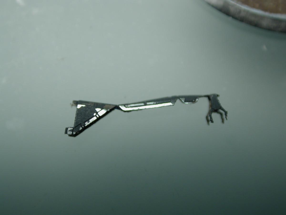

So now I finally get to the little 1/3000 scale valkyries. They look so good on the PE part, but are such a B^&$h to work with. I think I'm just getting old and my eyesight isn't what it used to be, but damn they're small!
Unfortunately after I cut out the launch arms, I promptly lost 2 of them - I've searched for 3hrs on my hands and knees and only found 2 of the four that were there. I guess 2 will have to do (unless some other kind soul would like to send me theirs ;-). Note to all DO NOT CUT THEM OUT until you are ready to work with them, they are small and WILL BE LOST! Another note, Tamiya acrylics suck adhering to metal photo-etched parts! They scrap off even just looking at them wrong. I've painted and re-painted these tiny Valks white about 4 times due to various bits scraping off, or the airbrush spray was just too heavy to obscure the tiny etched line details on them. In the end, I suggest doing a black oil wash on them first to fill into the etched lines (very shallow), then a very light coat of white over it but still allowing the black lines to show through, afterwards, handling it with kid glooves till you clear coat protect it. The launch arms are really tough to bend correctly, especially the tiny folds on either side of the long part of the arm, there just isn't much material to grab onto. The trickiest thing is to bend it into a U-shape - the first bend into an L-shape is easy, but when you go to the other side to do the U, you tend to flatten out the first bend. It took a lot of practice and trail and error - plus headaches because my eyes don't seem to focus down to something this small anymore. I've got to find one of those large magnifying glass on a gooseneck stand that will ship to Canada (checked out some cool ones at Amazon.com, but they don't ship to Canada - argh).
post-244-0-91422500-1349021690_thumb.jpg post-244-0-43679200-1349021694_thumb.jpg
post-244-0-26848300-1349021697_thumb.jpg post-244-0-25524400-1349021701_thumb.jpg
Note to self: paint after you bend them!

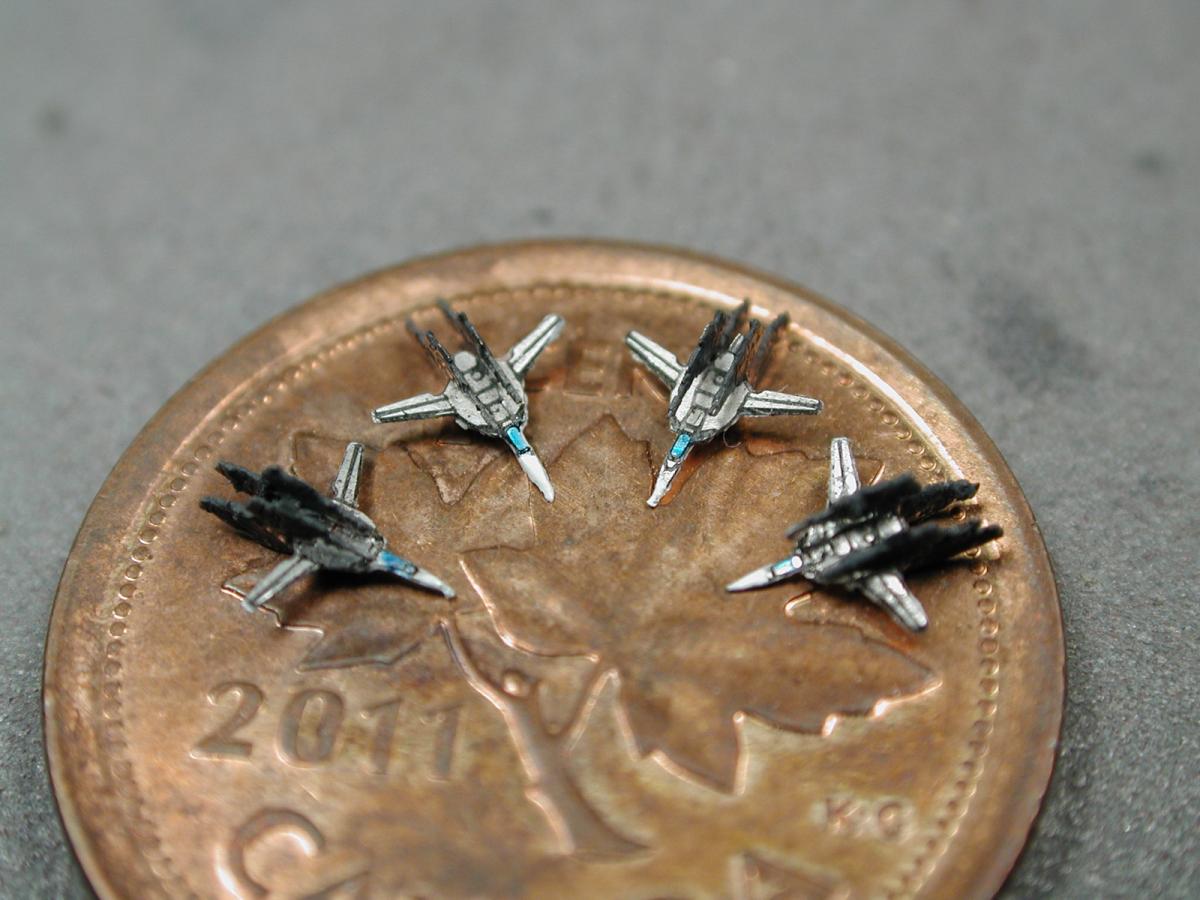

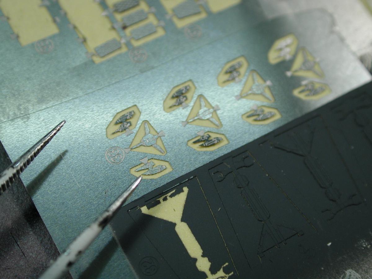

These are the fast packs - note they even have ones for the port side and different ones for the starboard side (strike cannons!)

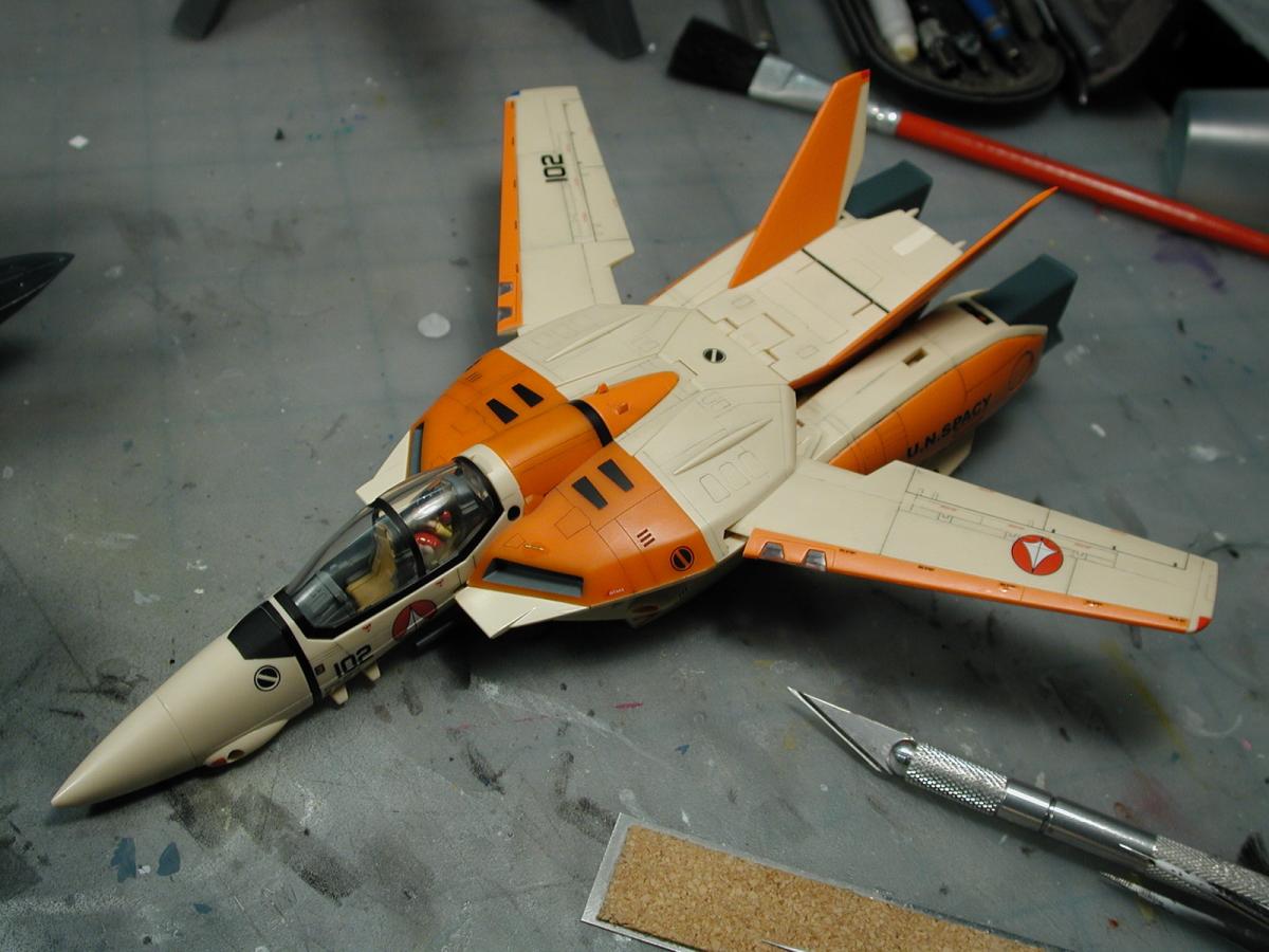

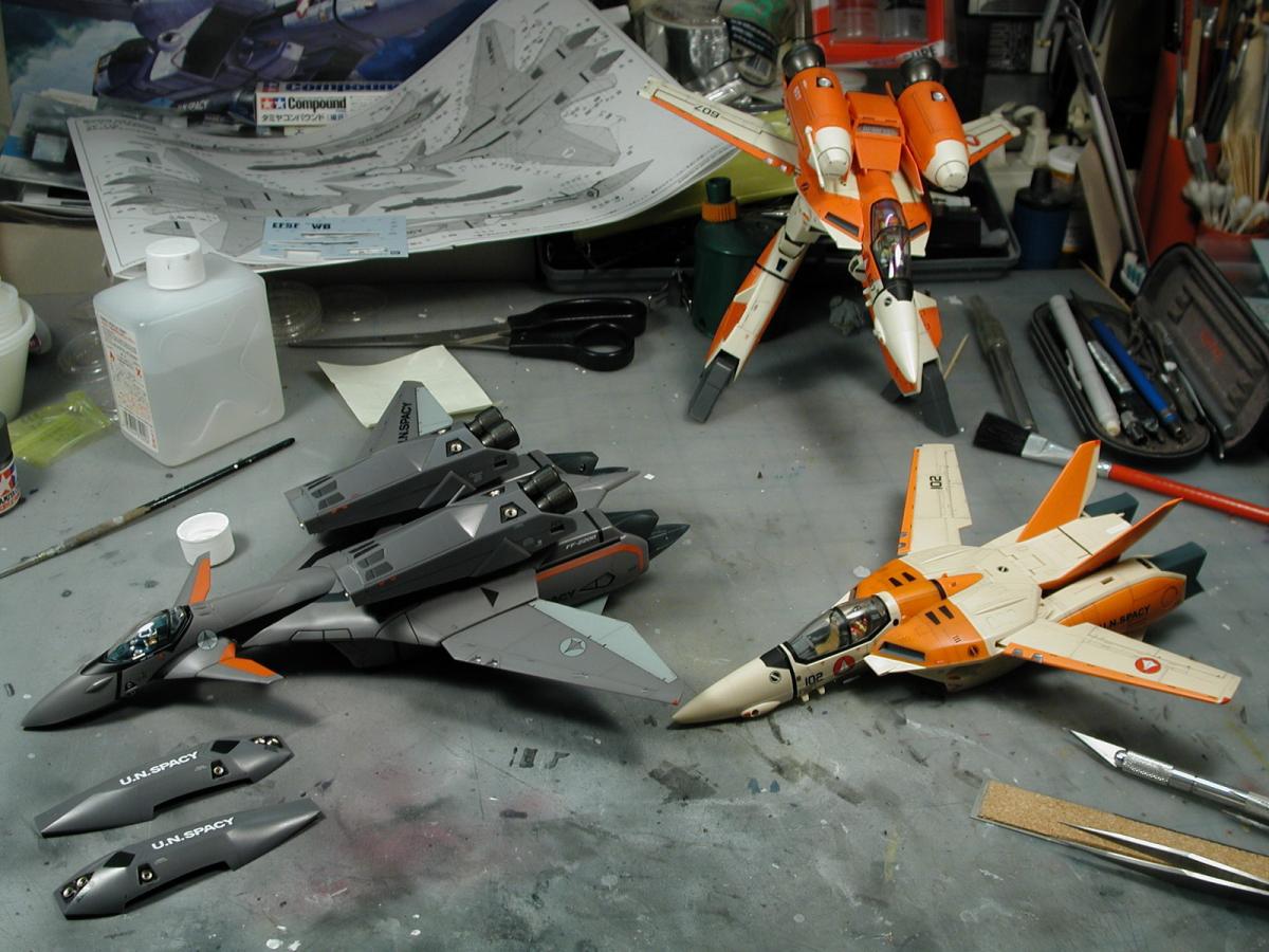

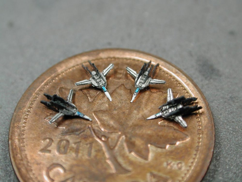

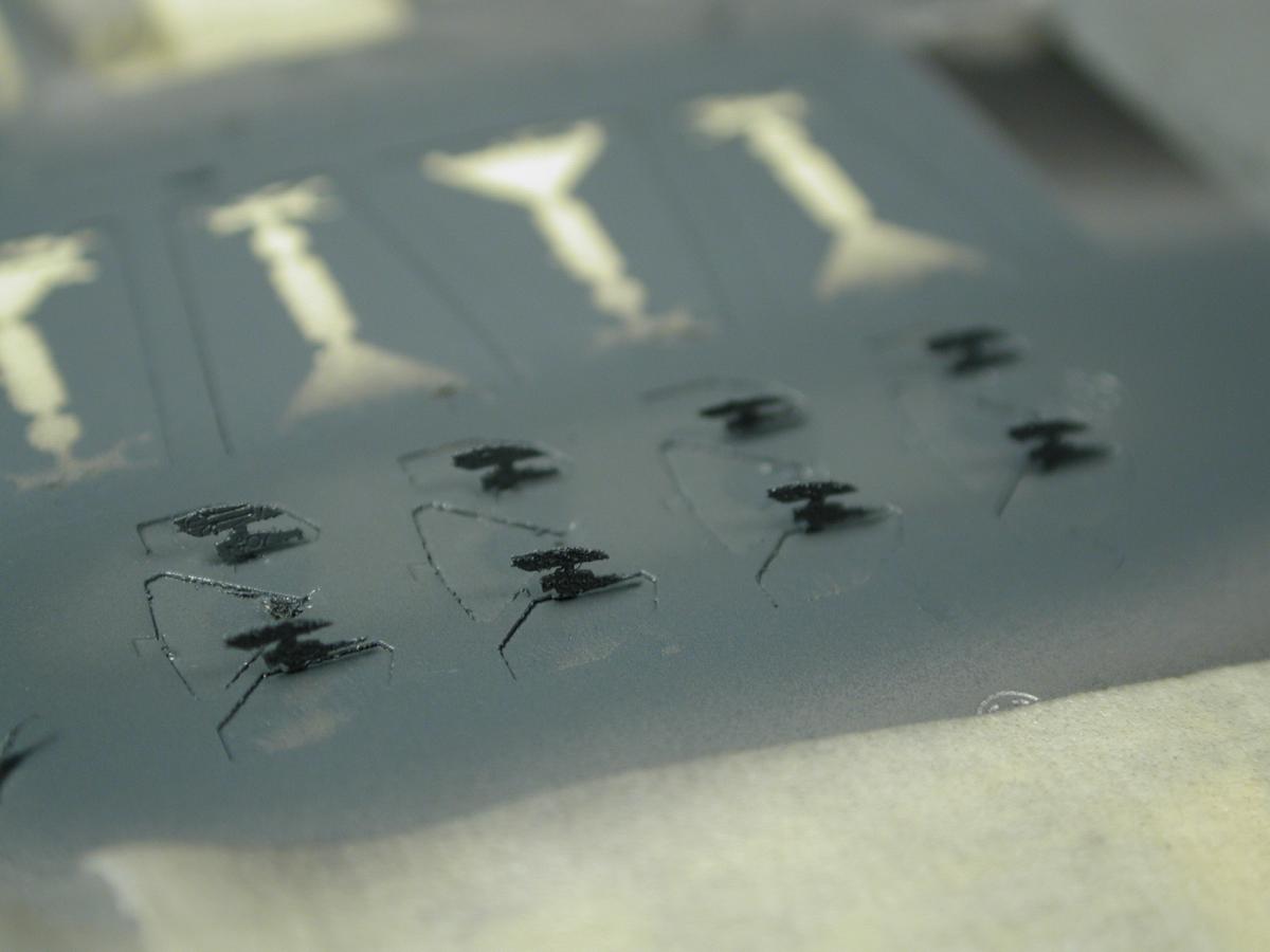

So while I'm letting the painted and re-painted photo-etched parts to dry, I've decided to decal and lightly weather/panel line my recent HLJ sale acquires; the VF-11 & VF-1D (the old VT-1 in the back was just for decal placement)
post-244-0-31933700-1349022043_thumb.jpg post-244-0-24005700-1349022047_thumb.jpg post-244-0-17381200-1349022051_thumb.jpg

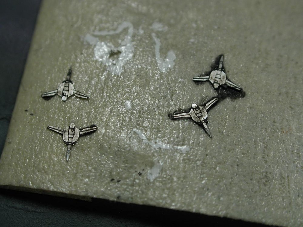

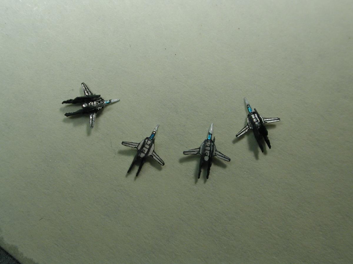

Here's to how the PE valkyries look after you oil wash them - quite a lot of detail for something so small! I just wished they were already in white photo-etched as a lot of this detail gets obscured when you paint them white - argh! Maybe that's why I haven't seen anyone who has used these PE Valkyries on their kit yet - hmm....
post-244-0-23365500-1349022251_thumb.jpg post-244-0-14656900-1349022255_thumb.jpg
That's it for now until they dry and I try to assemble the valks with their fast packs.

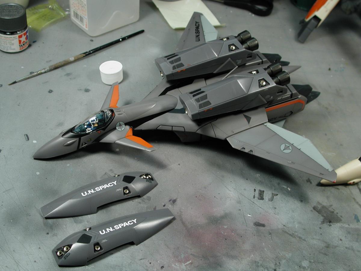

Yay! I'm too chicken to start right in on the VF-4 modification to FB2012 colours - so I thought I'll warm myself up by finishing off the SDF-1 finally after all these years ;-)

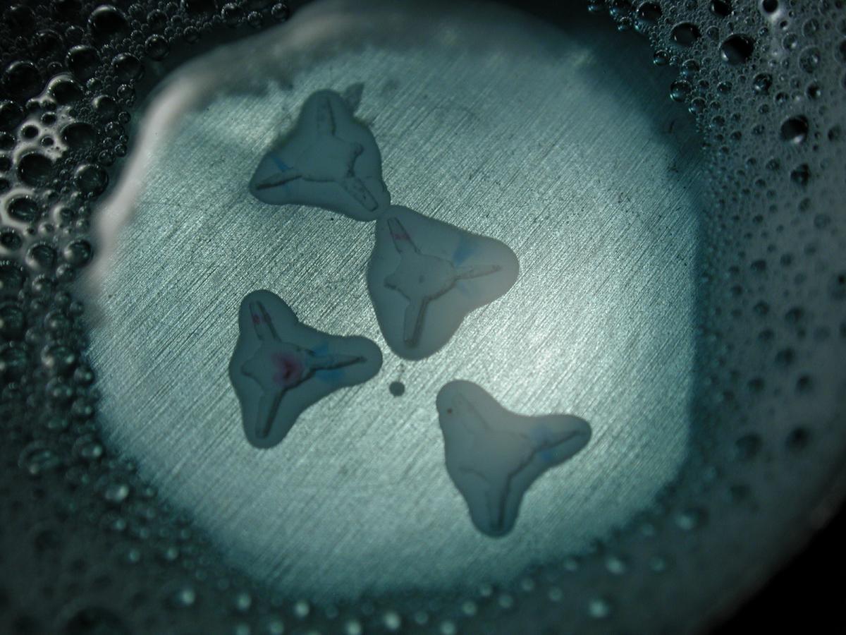

Just to back up a bit, I tried to paint those tiny photoetched 1/3000 Valkyries and it turned out to be a disaster. I tried 3 times, and each time it got worst. When I sprayed them white, I lost all the etched detail so the wash wouldn't sit inside the lines anymore because the white paint was in them (so shallow) and I tried to paint the red, yellow and blue squadron colours with the finest brush I had, but it was just too small for my old eyes. I ended up each time bathing them in Windex to strip the paint off and start over. So in the end, I left the top bare metal (luckily its silver and not brass) and did a dark black wash to pick out the PE details and painted the flat underside white.
post-244-0-41353600-1357933231_thumb.jpg post-244-0-09009400-1357933233_thumb.jpg
Yes, those PE backpacks are a b#$@h to glue together, they fit perpendicular to the valkyrie and there's a left and right pack, one has the beam canons! It took me about 3hrs to get the four Valkyries assembled and I ended up with one crappy tester, one ok passable, and two decent planes. Luckily I had lost 2 of my launch arms, so I can only use the 2 good planes that turned out anyways.

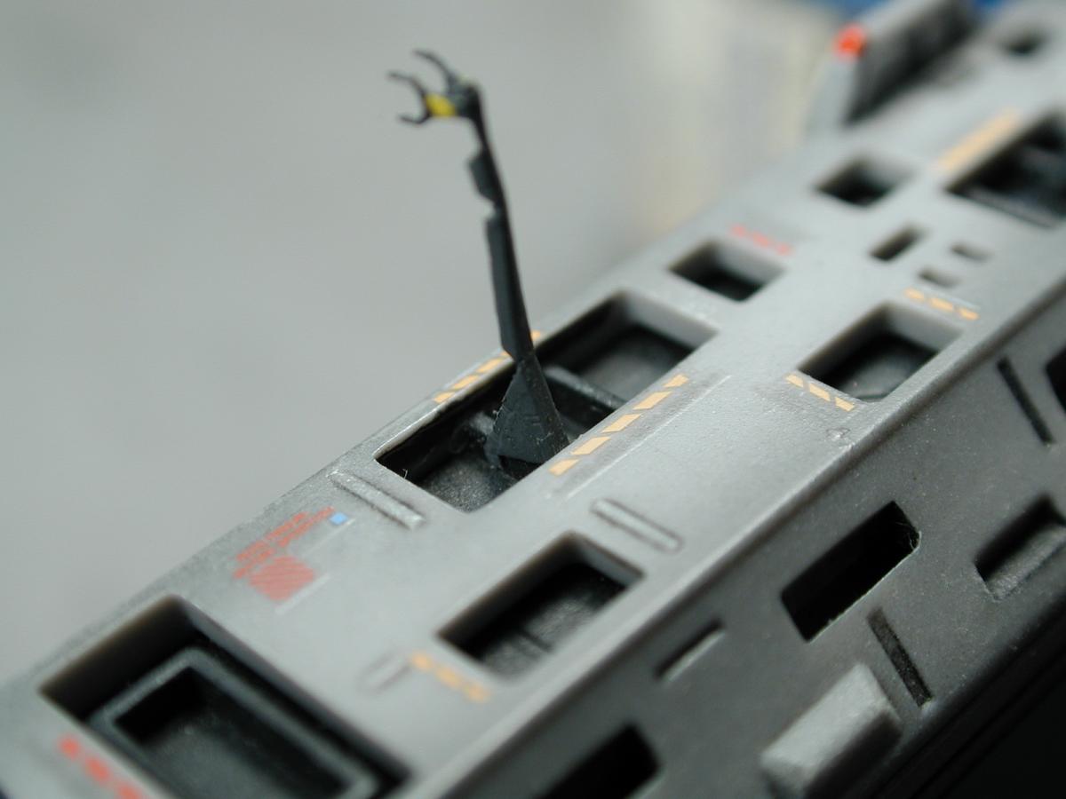

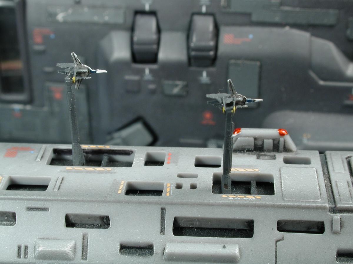

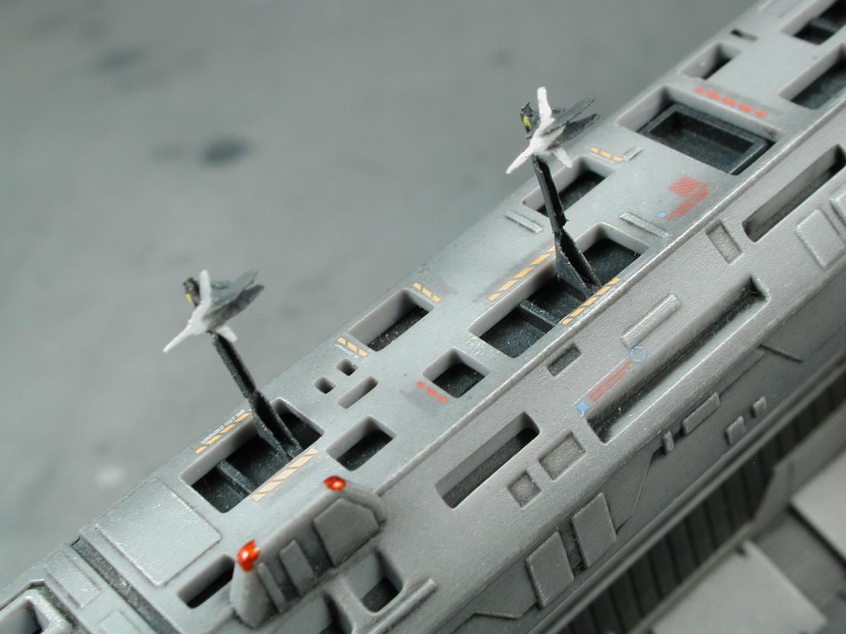

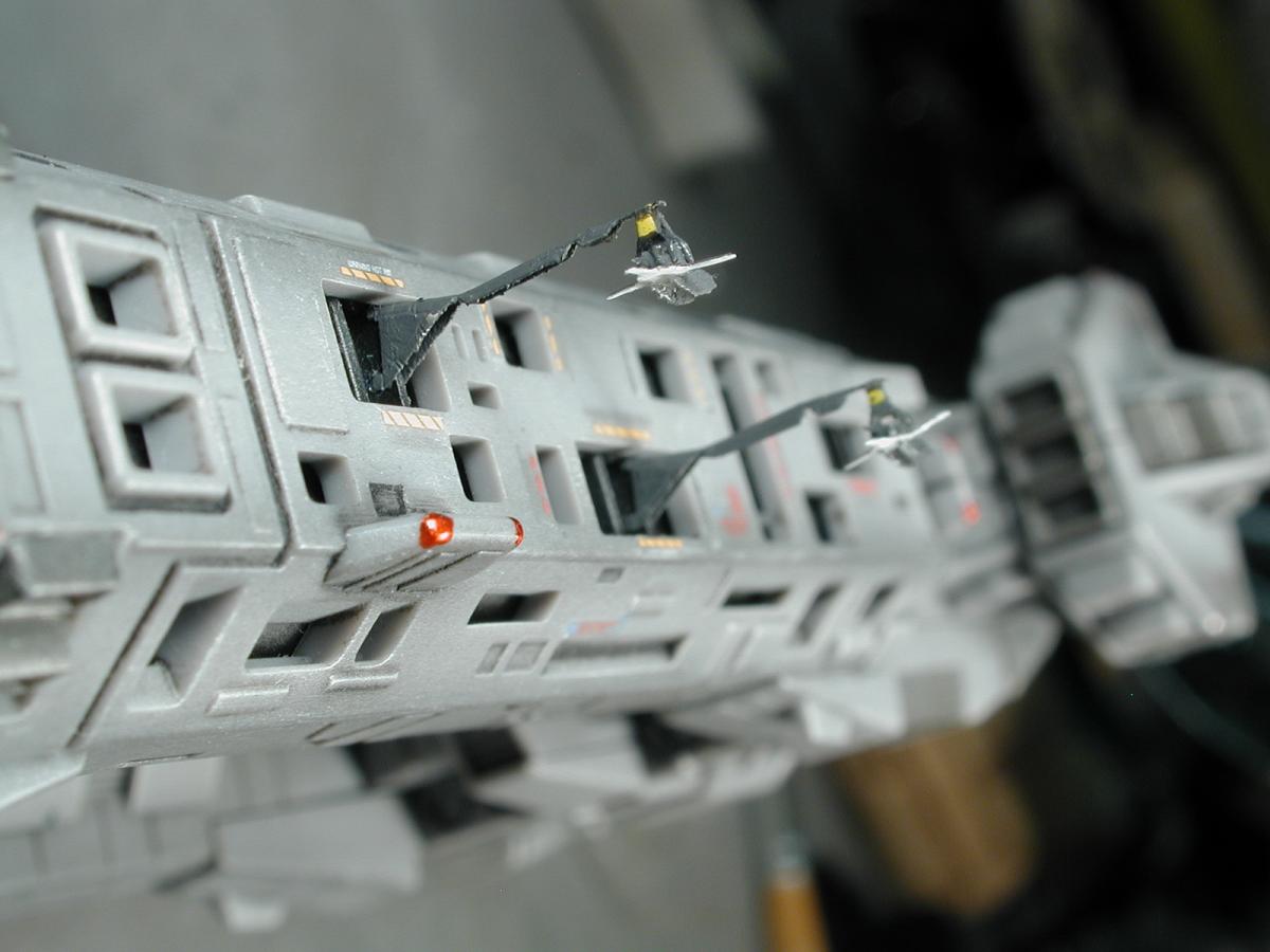

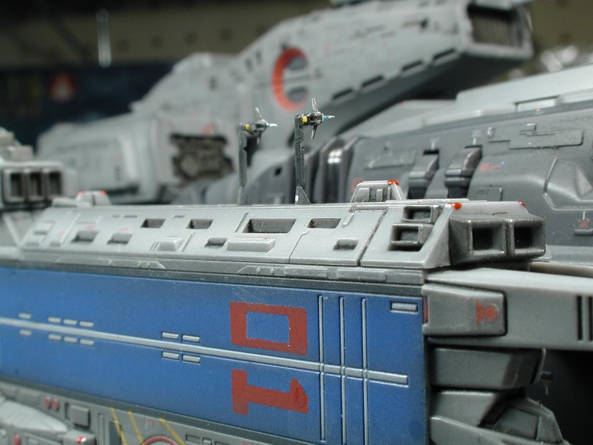

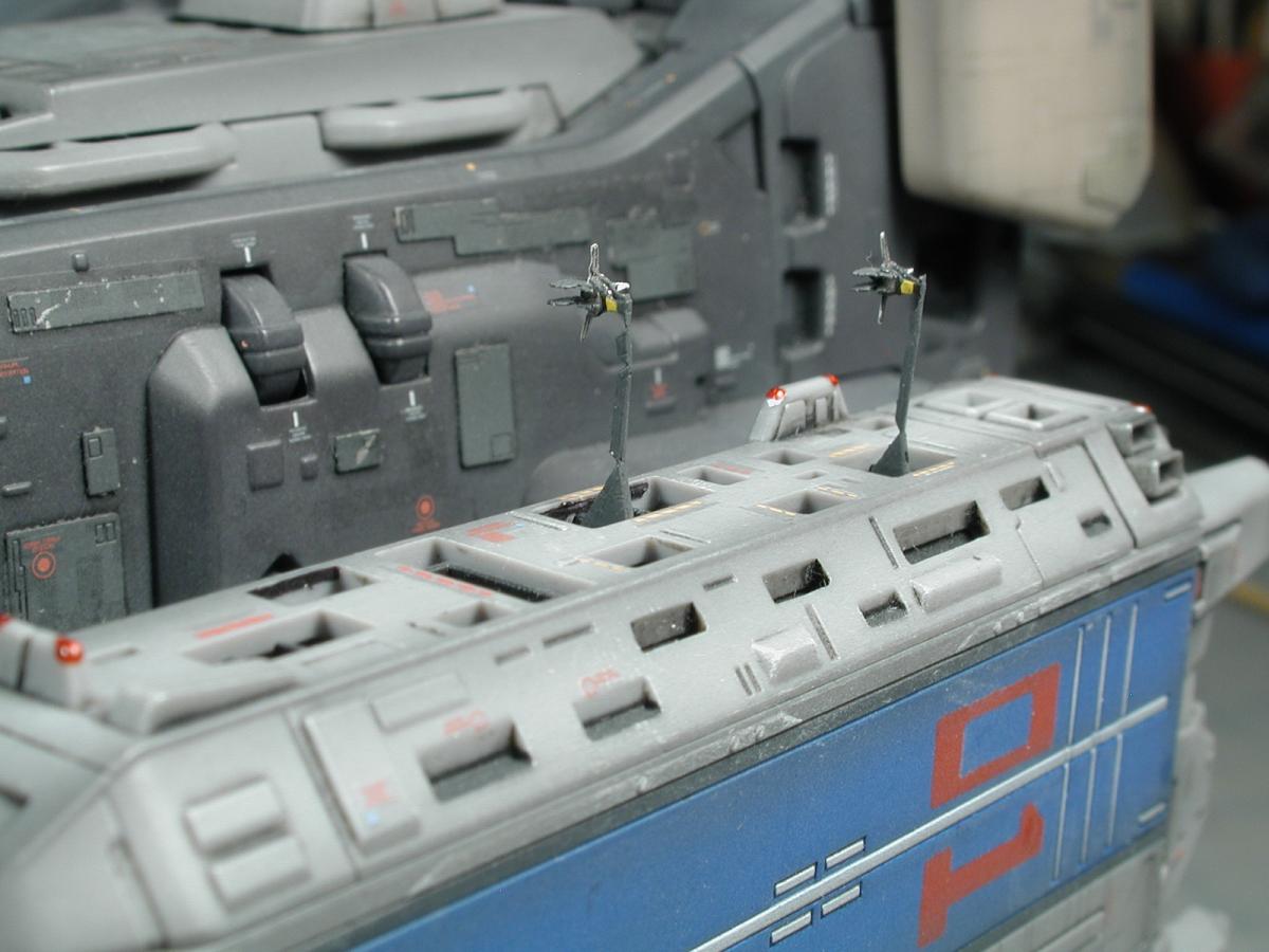

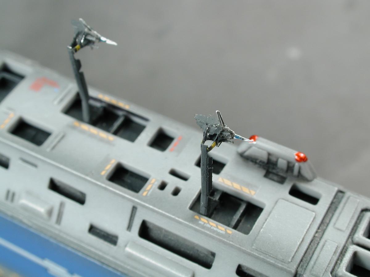

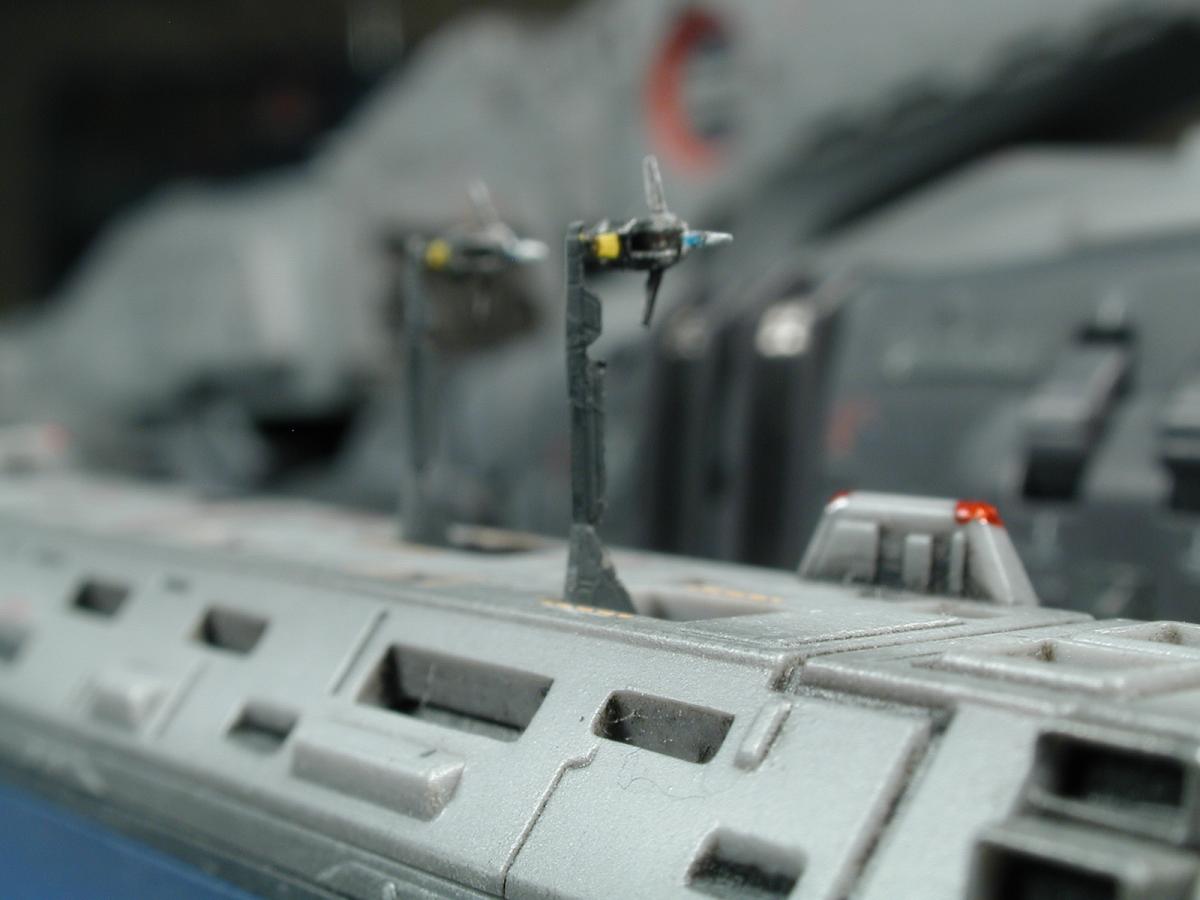

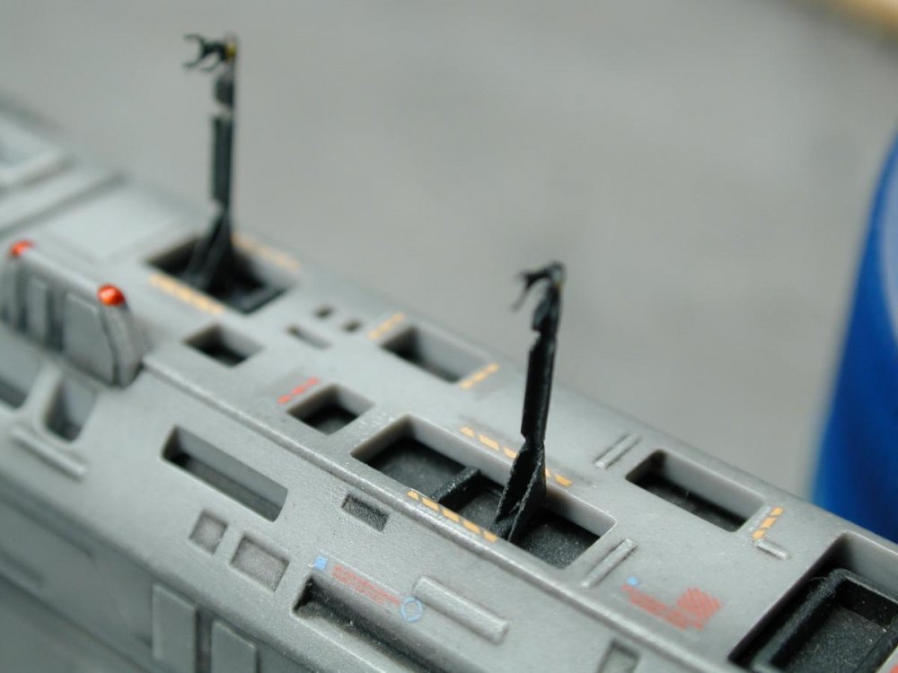

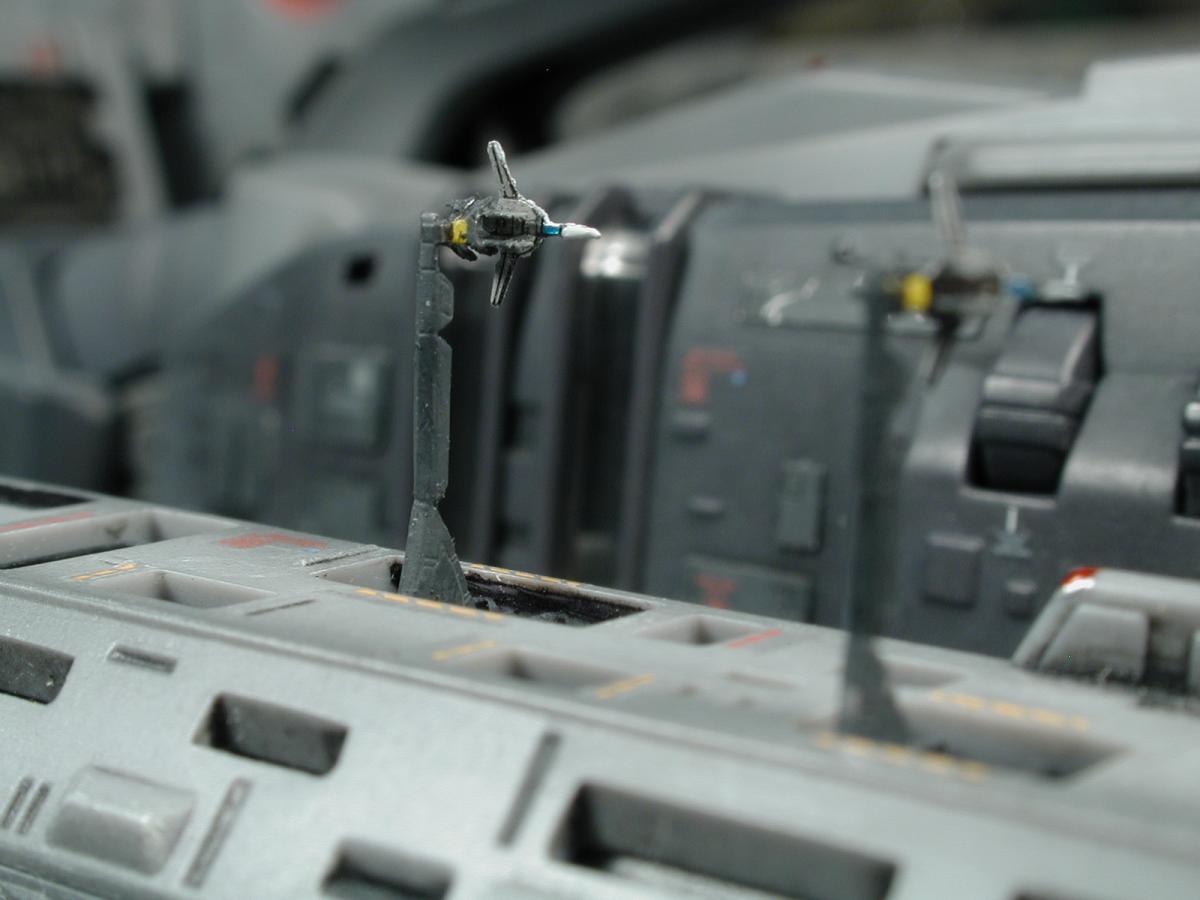

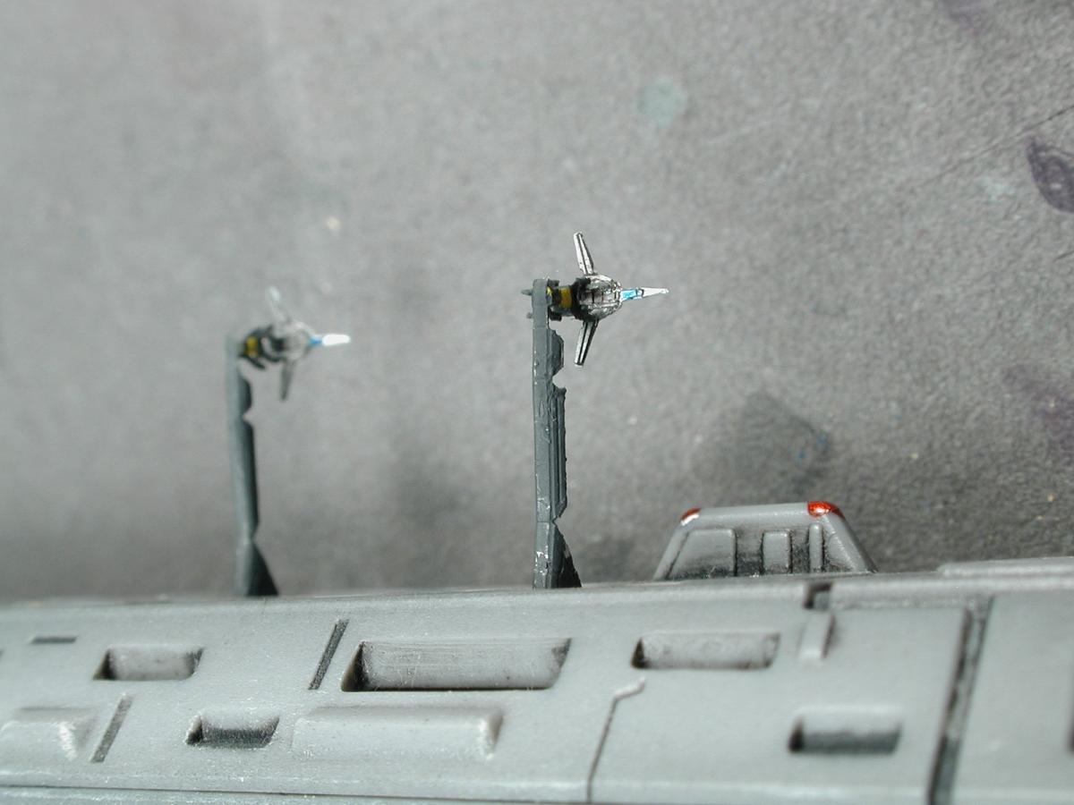

These next photos show how I'm attaching the PE launch arms, I just folded the base and that friction pressure is what's grabbing onto those molded vertical ribs within the black opening - its just friction fit, I thought I might just put a dab of "white" glue to hold them in place, if I were to handle the toy a bit more (for now I'm just leaving them).
post-244-0-63874000-1357933575_thumb.jpg post-244-0-97843800-1357933576_thumb.jpg

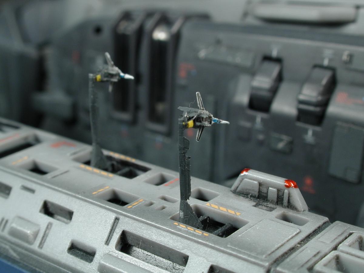

And with a tiny dab of thick crazy glue, they held. You have to play with the "claws" a little bit (pry them open with some 000 tweezers) depending on how vertical you got your fast packs glued onto the Valkyries. Luckily I had to only choose the 2 best ones that turned out of the 4 that I made. Then a little "twisting & turning" once its mounted to get them aligned and true the way I wanted them to appear on the ARMD openings.

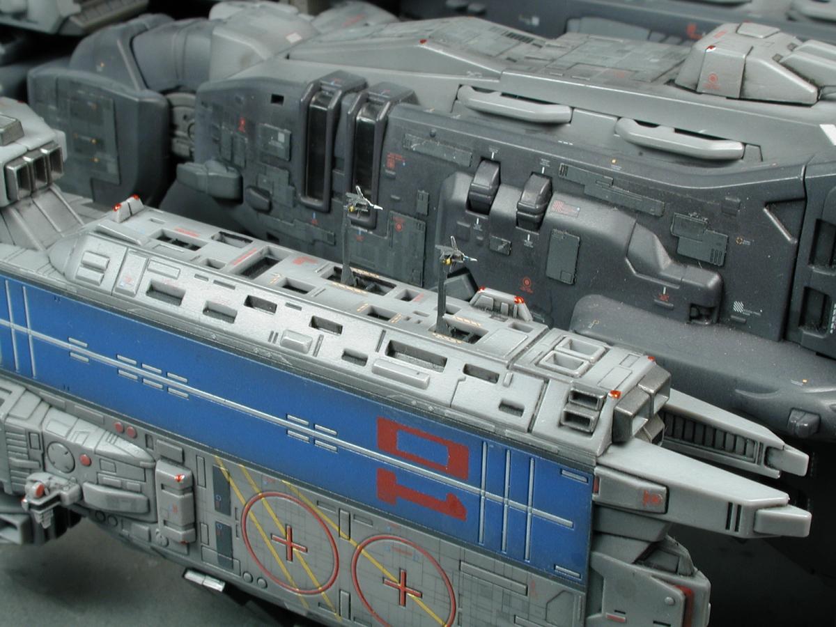

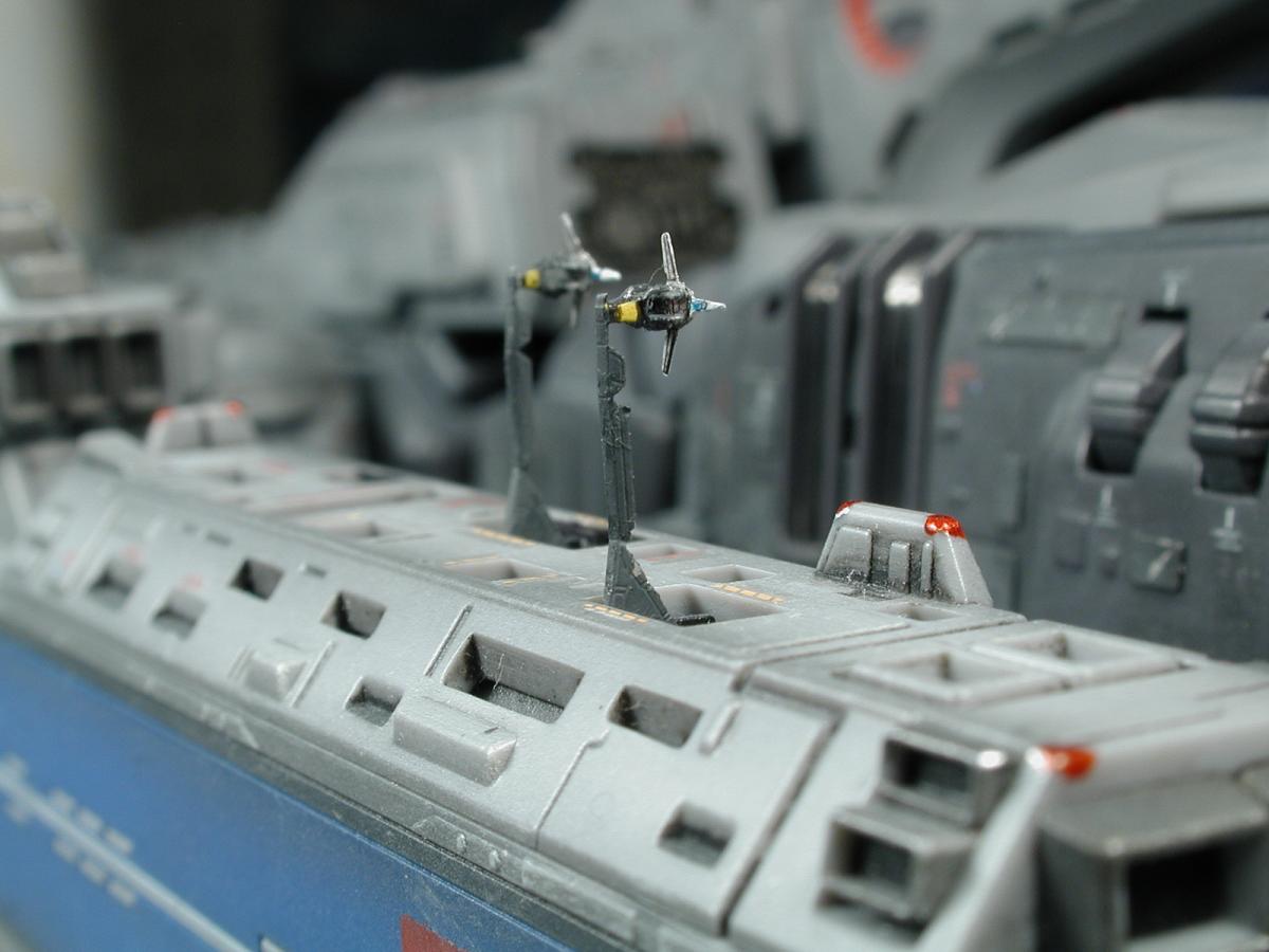

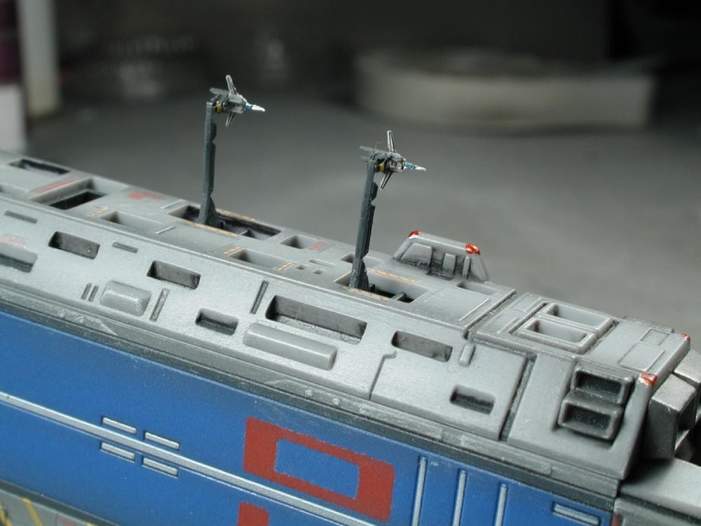

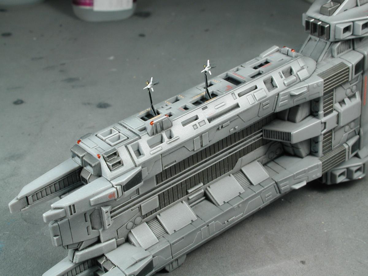

So here are some better shots of the ARMD with the attached launcharms and Valkyries finally attached to the rest of the SDF-1!
(I need to dust this baby a bit when you're taking macro photos so close, every piece of dust shows up!)

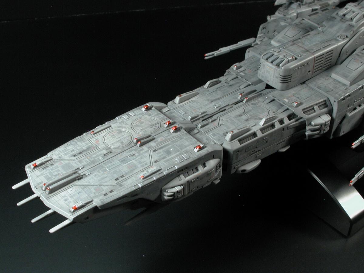

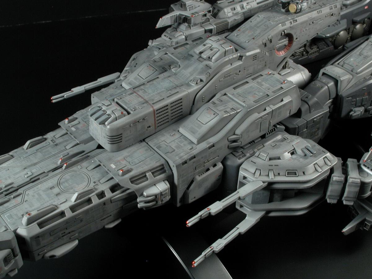

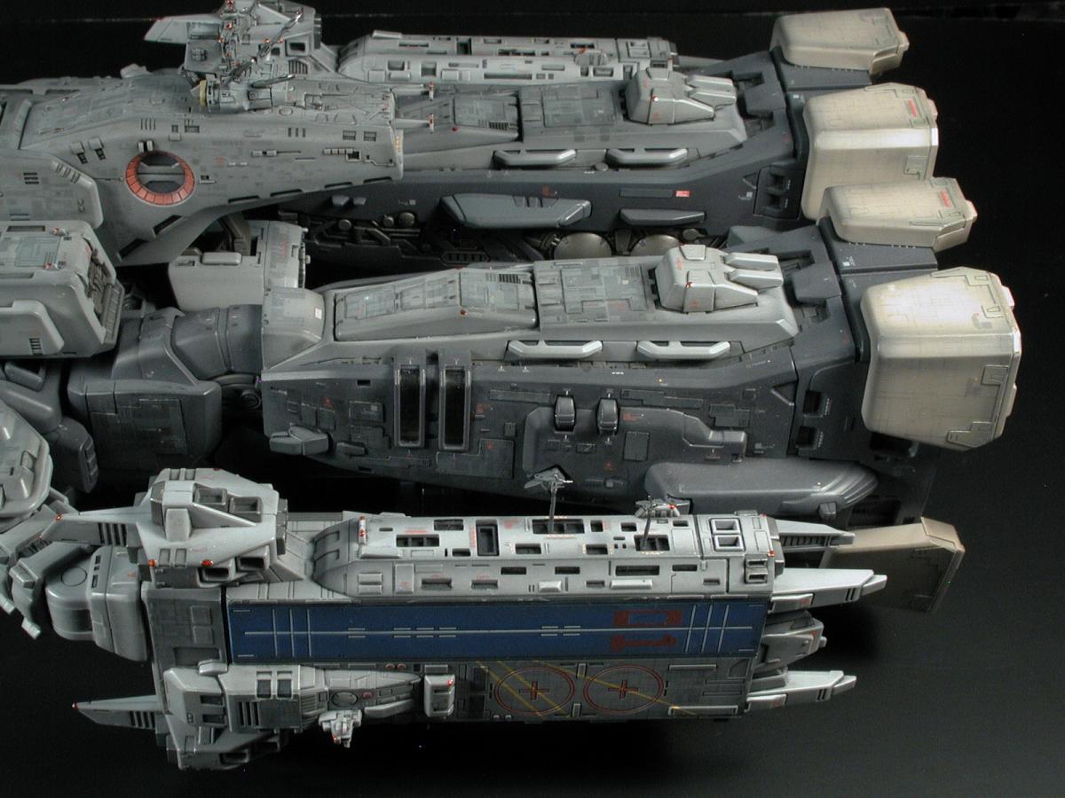

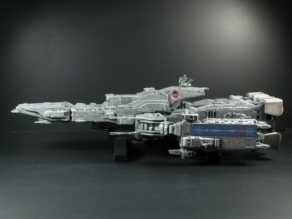

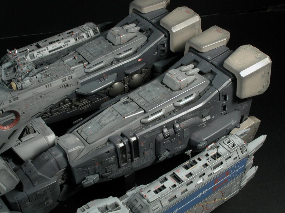

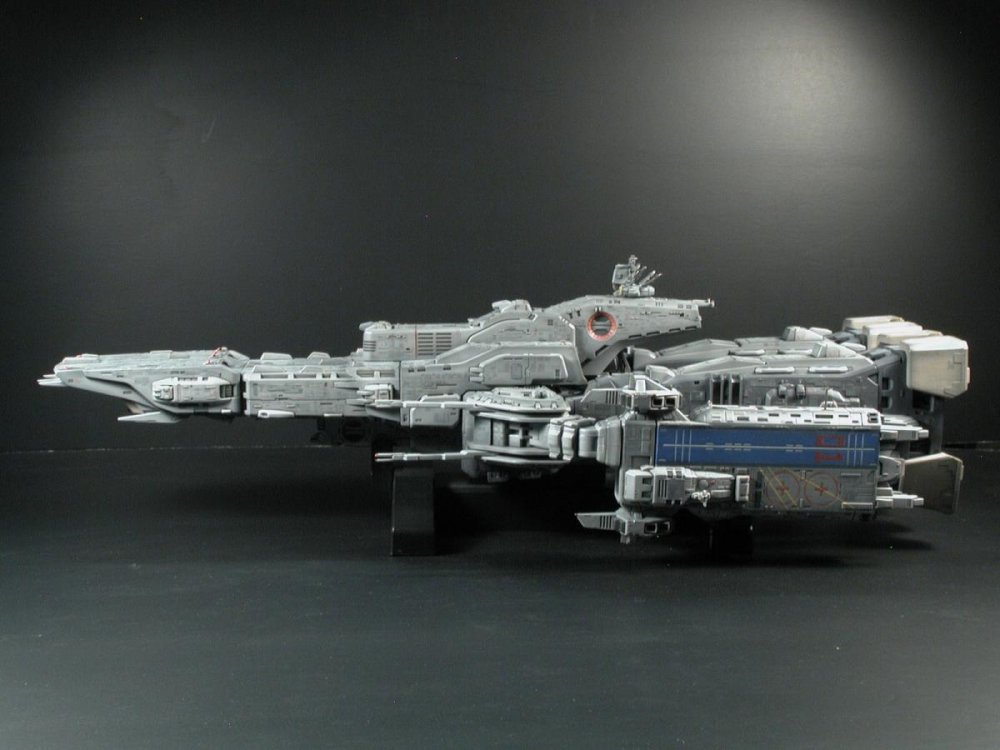

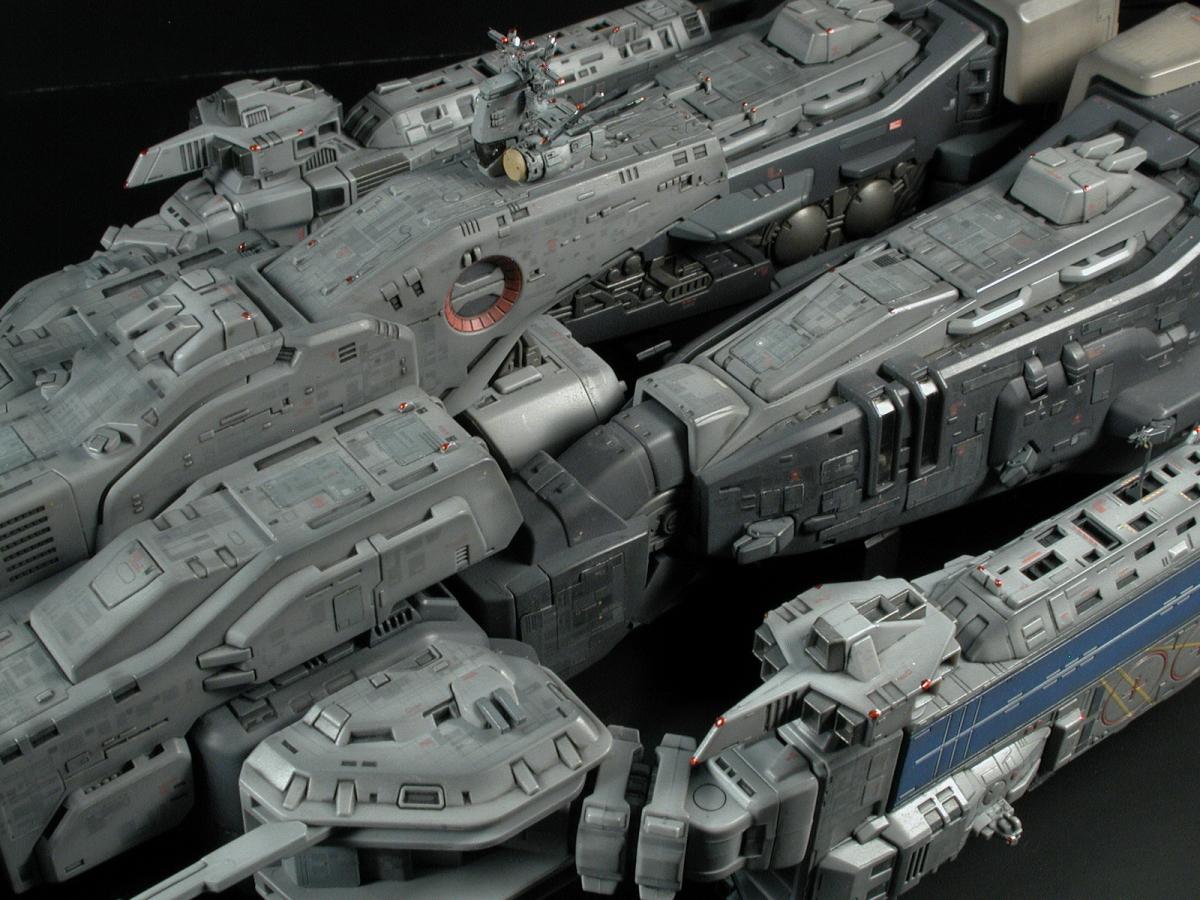

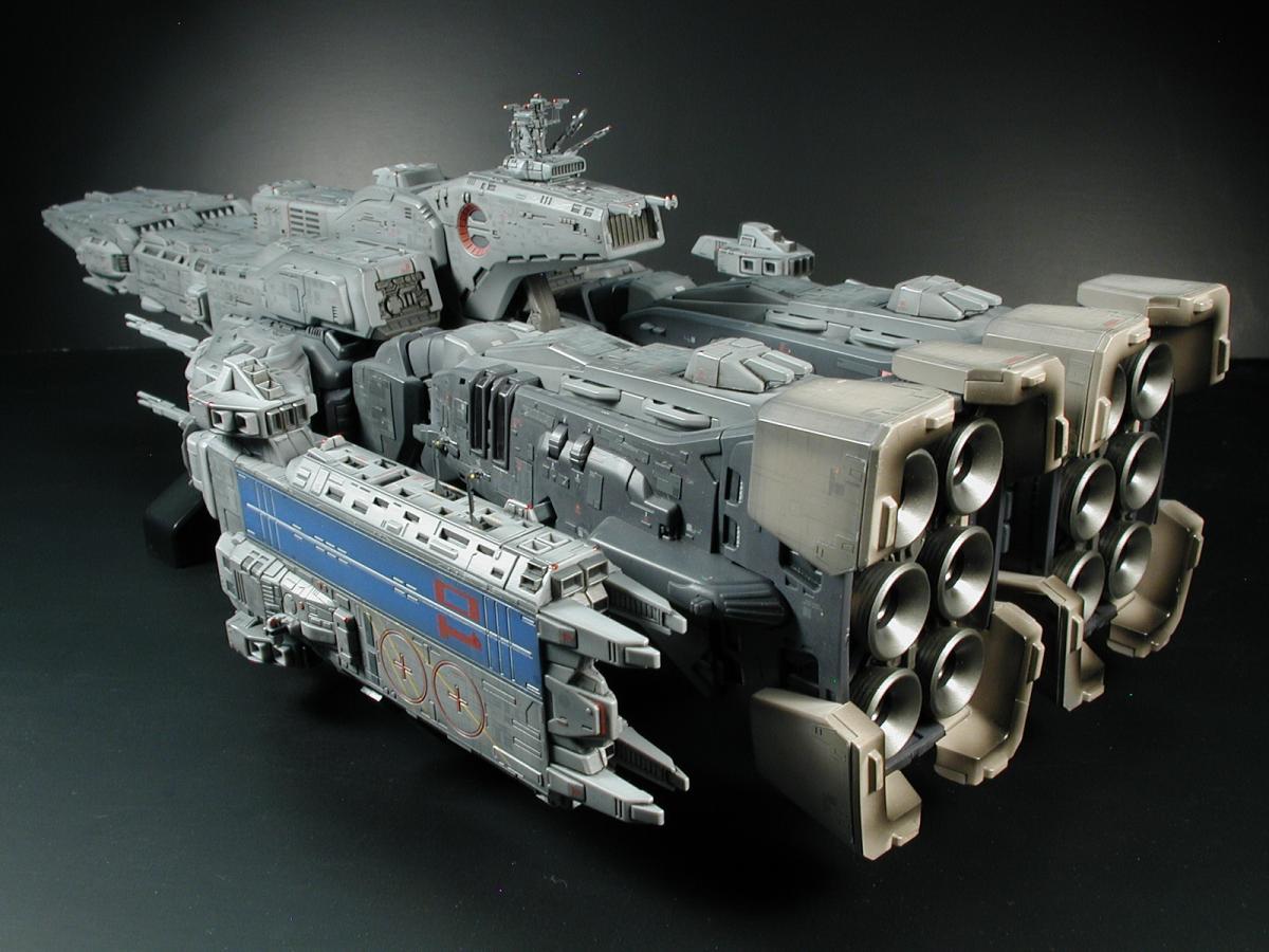

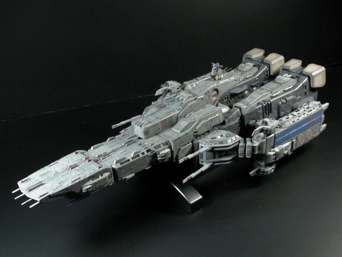

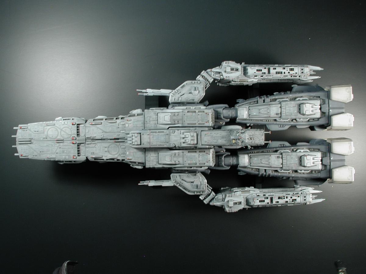

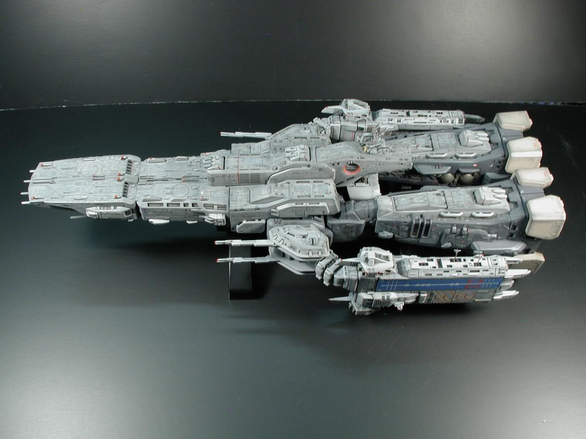

So lastly, I took some quick pictures of my baby. I couldn't go outside to get proper lighting (its fricken cold in Canada in the winter!) so I probably won't get decent shots till the Summer. This will have to do under proper shots are done. This is just on my workbench with whatever black foam core I could find lying around the basement so you get the idea!

Wow, good job. Man, that looks like a really severe pain in the butt to do. With my luck, I'll probably end up breaking the claws or something. I'm not sure how you managed to glue those tiny things together so the legs and boosters are perpendicular to the main body. There doesn't seem to be much surface area to work with for gluing.
Beautiful! I didn't think the pencil lines would make much of a difference, but those shots changed my mind. It adds a nice subtle yet noticeable difference. I may have to try that with mine too. I only did the feet like that on mine so far because they just looked so plain otherwise.
I purposely made the conscious decision that this was a painted toy and not a model, so I left a lot of the delicate "needle-like" antennas all over this ship off - I'm not sure if I made the right decision now, but I had intended to transform it once it a while (otherwise I would have puttied and sanded every seam). Some of it is my laziness and just wanted to cut down the scope of the work involved, but basically every one of my "real-world" fighter models that had delicate pilot tubes and lightning rods (F-16) have broken off over time despite my careful handling. Oh well. The photos do get progressively better as I shoot it - like everything, I get rusty when I haven't done it in a while.

Well, overall I am very happy with how it turned out and admire the ones on these boards that have gone through the extra effort of lighting them - BRAVO! That's just beyond me at the moment. Maybe in 10yrs or so when I'm no longer the center of my daughter's universe I might return to modelling like I once did, but for now, toy collecting has taken over and will have to do for now. Yamato has really outdone themselves with this stellar offering and I wholeheartedly recommend this toy to anyone still sitting on the fence about it - its truly remarkable. This and the new VF-4G Lightning has to be my all-time-favorite offerings from Yamato.
...There doesn't seem to be much surface area to work with for gluing...
Yes, but the trick is the underside, the "leg/intake/engine" portion of the fast pack sits flat against the underside of the horizontal portion of the Valkyries, concentrate the glue to the underside and build it upside down, the top will take care of itself if the bottoms are aligned properly. Also the thicker crazy glue will help, and do one fast pack at a time - the rest is just patience and where your personal frustration point ends up being :p
If it makes you feel any better, I keep knocking off the needle like photo-etch parts on mine several times a day while working on mine despite super gluing them. I'm near the point where I say screw it and rip them off. got a few scratches from them as well. Almost poked my eye with one also. That would not have felt good.
As for the puttying, I gave up on that after the multiple times I've found there was a problem with a mechanism after I had already assembled and puttied painted and decaled/applied PE, only having to take them apart again and see if I could figure out a fix. I don't know why, but the toy version parts seems to be less flawed than the kit. I know I put it together correctly too, because sometimes the problem only occurs on one side like the left arm vs the right.
Yours looks amazing regardless and I can only hope that mine looks half as good as yours when I'm finished.
