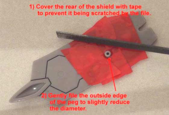

The only genuine problem that Yamato have found is that some of the shields will not stay on the arm in fighter mode, because the attachment peg is slightly oversize. If you do encounter this problem with your toy there are two things you can do: -
  1. Very carefully reduce the diameter of the peg by filing it with a small file. Don't go crazy with the filing! Just file a couple (and I mean a couple) of strokes, test the shield and if it still doesn't fit file a couple more strokes, test etc etc until it fits. make sure you also cover the back of the shield with some tape to prevent it being scratched by the file.

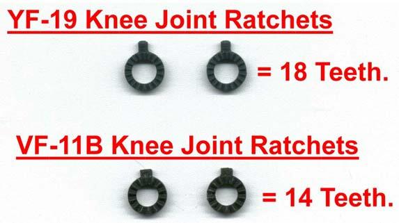

Anyway, one thing I have noticed recently is that in response to fan feedback Yamato have increased the size of the teeth on their ratchets. The YF-19  knee joints have 18 small teeth and some consumers complained that these teeth wore out too quickly. On the VF-11B Yamato has reduced the number of teeth and increased their size.

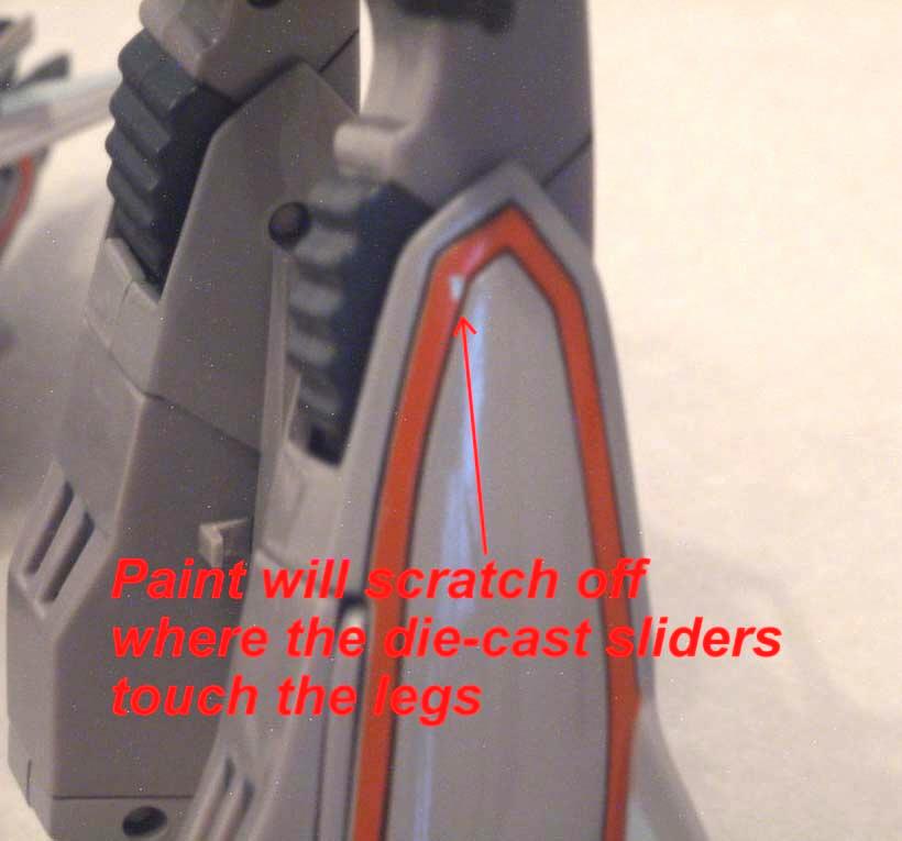

One of the few real problems with the VF-11B is that the die-cast metal shoulder slider will rub against the leg in fighter mode and sooner rather than later will start to rub paint of the leg at the contact point (see pictures below).
I can't think of any way to solve this problem and for Yamato it is really one of those no-win situations. What I mean by that is that on the YF-21, the slider was plastic and on the early toys broke rather easily. So Yamato changes to a metal slider for greater durability on the VF-11B, but of course where metal rubs metal you get wear. Yamato could always change to a plastic lower leg, but then fans would scream that they are reducing the die-cast content. Like I said, a no-win situation!
