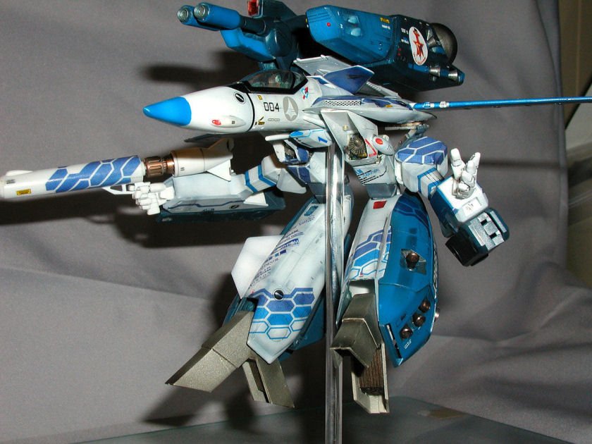

007-vf1 Posted December 9, 2006 Posted December 9, 2006 (edited) This is one of my favorites walk convertions and the first Gerwalk I made using the same magazine gidelines. Just keep in mind I am not trying to sabotage this tread but just show the potential...especially for the newbies that might have missed my old treads. enjoy.. Edited December 9, 2006 by 007-vf1
jipe Posted December 9, 2006 Posted December 9, 2006 Great conversion. I had to try the same way to have better ones than the imai kits...
Chas Posted December 10, 2006 Author Posted December 10, 2006 (edited) Just keep in mind I am not trying to sabotage this tread but just show the potential...especially for the newbies that might have missed my old treads. Don't sweat it! The more the merrier! So that's a Hase. fighter kit with an Imai battroid kit cool! I'd thought about doing that but I didn't think it would look that good. Guess you proved me wrong. Didn't you build two gerwalk conversions? I'm pretty sure it was your build-ups that inspired me to do my own. Edited December 10, 2006 by Chas
007-vf1 Posted December 10, 2006 Posted December 10, 2006 Don't sweat it! The more the merrier! So that's a Hase. fighter kit with an Imai battroid kit cool! I'd thought about doing that but I didn't think it would look that good. Guess you proved me wrong. Didn't you build two gerwalk conversions? I'm pretty sure it was your build-ups that inspired me to do my own. Yeah the Imai conversion was the first I made; but I only used the slide arm system from it. Most of it still is a couple of hasegawa kits. The second 2 you saw on an old post were for comission and I did them using the technique you applied on yours which I also follow them from the same magazine. In the end I found out it was the simplest and less brain bugging way to go. Best part is that it took me half the time than what took to build the first one. My suggestion is that you can only learn by trying.
